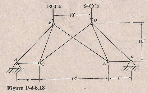

Frame Analysis Using Method of Members.
Determine the force in bar BE.
2. Well, I don't know where to start. I know there are three equations EFy=0, EFx=0, EMc=0 but I don't know what the first member to consider and how to solve this type of problem.
There is a final answer given, BE = 2410 lb (Compression)
I am trying to isolate the left and right trusses. Is that the right thing to do?
Please help, Thanks!

Yes, that is correct.
