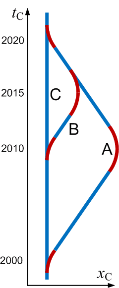

morrobay said:
This excellent graph by Dr Greg is clarification on acceleration / velocity and time dilation for two travelers : https://www.physicsforums.com/showthread.php?t=354622&page=2
See Post # 36
Here's Dr Greg's graph:
I can see the accelerations (in red) and the velocities (in blue) but where do you see any clarification on time dilation?
With explanation. As Yuiop says in Dr Greg's graph: With identical acceleration events the difference in time dilation is accounted for only by time in relative higher velocities. And in also answering the OP question :
Then does that also mean the twins are aging at the same rate only until the brother undergoes
acceleration ?
Here's that graph again:
Yuiop misspoke. When he said "time dilation", he meant and should have said "aging". The point of the graph and yuiop's explanation is that since A and B both experienced identical acceleration events and therefore attained identical velocities (and identical time dilations or aging rates), the difference in their aging is accounted for only because A spends more time at the higher velocity than B does.
Then does that also mean the twins are aging at the same rate only until the brother undergoes acceleration ?
Neither the diagram nor its explanation addresses that question by the OP. Chogg answered that question in post #3 by saying that the aging rate (or the time dilation) is frame-dependent. So even before the turn-around acceleration, they are not aging at the same rate in the diagram above.
Time dilation and aging are related by Δt' = γΔt. For .6c, γ=1.25 So "time between ticks" of
travelers clock is longer. Hence less aging.
Regarding your second paragraph : I stated exactly the same thing : Even before turnaround point
they are not aging at same rate. The overall picture is that the traveling twins aging is dependent
on velocity before turnaround point and acceleration / frame change at turnaround point.
See this numerical example I did in post #3 www.physicsforums.com/showthread.php?t=734695
You cannot relate time dilation and aging that way. The ##\Delta{t}## in that expression is the difference between two coordinate times, not proper times.
Indeed, I could use exactly the same argument you're making here to show that stay-at-home will age less: during the entire journey, stay-at-home is moving relative to the traveler, so the "time between ticks" of stay-at-home's clock is longer (##\gamma## may change as traveller accelerates and decelerates, but it's always greater the one), hence less aging for stay-at-home.
That's the paradox in the Twin Paradox: I can apply the time dilation formula in two seemingly equally valid ways, yet get different results.
morrobay said:
Time dilation and aging are related by Δt' = γΔt. For .6c, γ=1.25 So "time between ticks" of travelers clock is longer. Hence less aging.
Yes, if you mean longer than the Coordinate Time of the particular frame that you are depicting the scenario in. But it isn't the aging rate (which is the inverse of the Time Dilation) that yuiop was talking about. Here's his quote
The issue of whether the differences of time dilation in the twins paradox is caused by acceleration or relative velocity has come up several times in this thread. The diagram below (created by Dr Greg a long time ago) shows a way to eliminate acceleration from the considerations. Observers A and B undergo identical acceleration events (The curved sections highlighted in red) and yet less proper time elapses for observer A than for observer B. The difference in time dilation in this example can only be accounted for by the difference in time spent at higher relative velocities.
There is no difference of time dilation for observers A and B during their times spent traveling. Yuiop didn't mean time dilation. He meant differences in accumulated age from the start of the scenario when A and B were colocated to the end of the scenario when they were again colocated. That's the only way you can compare differences in aging and it doesn't matter what frame you use to depict it whereas time dilation does depend on the frame.
morrobay said:
Regarding your second paragraph : I stated exactly the same thing : Even before turnaround point they are not aging at same rate. The overall picture is that the traveling twins aging is dependent on velocity before turnaround point and acceleration / frame change at turnaround point.
In the particular frame depicted in the above diagram, it is true that the twins age at different rates before the next acceleration but we can transform to a different frame in which they are traveling away from each other at the same speed and they will be aging at the same rate. The OP needs to know that the aging rate (or time dilation) is dependent on the frame and not just on periods of acceleration. Here's his question:
Then does that also means that the twins are aging at the same rate only until the brother undergoes acceleration?
The OP needs to know that we can always pick a frame in which two observers age at the same rate at any particular time, even if they never accelerate, and we can pick another frame where either twin ages more than the other at any particular time.
