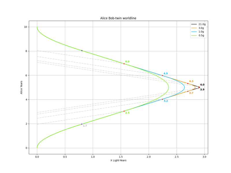

I did the following graphic, and perhaps could be useful to understand what happens.
In the graphic, Bob starts accelerating always at 0.5g until it reaches speed 0.7c, and there're several scenarios where he deaccelerates at 0.5g, 1g, 3g and 21g. Dashed lines are the lines of simultaneity at the proper times in which the deacceleration begins.
According to what frame?
I like to use inertial frames when solving the Twin Paradox, and I think a crucial part is to assign coordinates to three events. Event 0 departure, event 1 turnaround and event 2 reunion. The stay home twin is only present at two of those events, whereas the travelling twin is present at all events. Using the correct transformations and spacetime separations, if the stay home twin has a proper time between events 0 and 2 of ##T##, then the sum of the proper times for the travelling twin ##\tau_{0,1}+\tau_{1,2}## will always be ##\frac{T}{\gamma}##.
(After consulting my lawyer,) according to the inertial frame of Bob that travels at a constant speed of 0.7c relative to Alice, just an infinitesimal time before Bob starts deaccelerating.
