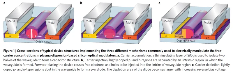

I'm by no means expert on this topic, but doped-silicon optical modulators can apparently accomplish this (although not necessarily in the specific single-layer configuration you're proposing):
This diagram is taken from the freely-available 2010 Nature review article: https://www.researchgate.net/publication/232752299_Silicon_optical_modulators_Review.
I suggest you read through this paper and use it as a starting point to drill-down further into the literature, in order to judge if your ideas can really improve on existing optical-modulation technology.
Apologies—I realized I moved on to a follow-up question before properly acknowledging your earlier comment.
Thank you — I appreciate the reference, I'm going through that paper now.
I can see the connection to silicon photonics and plasma-dispersion modulators, and that helps frame things.
One thing I’m still trying to understand is how well that kind of effect carries over to a simple transmissive layer. In waveguide devices, the interaction length is relatively long, whereas in a thin film it would be much shorter.
My intuition is that this might make the phase shift quite small at visible wavelengths, but I’m not sure if that’s the right way to think about it.
