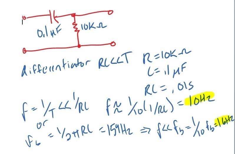

part 1. at what frequencies will the circuit act as a differentiator?
part 2. interchanging R and C of figure D produces a low pass filter. At what frequencies will v_out/v_in = .95?
part 3. at what frequencies will the RC circuit of problem 18 act as an integrator?
part 4. design a low-pass filter that has v_out/v_in =0.5 at 5kHz
part 5. for the cicuit that you designed in problem 20, at what frequencies will v_out/v_in equal .01 and .99?
I have completed part 1 but I am having issues in understanding where to begin for the other parts of this problem. I have attached my work and as well the circuit. any help would be greatly appreciated! thanks pf!
  • Handwritten RC differentiator circuit: a 0.1 µF capacitor in series with input, a 10 kΩ resistor to ground across output; notes give R = 10K, C = 1 µF, RC = 0.01s, f ≈ 1/(10(1/RC)) = 10Hz, and fb = 1/(2πRC) ≈ 15.9Hz.
For part 2, you analyze the low pass filter as a potential divider, not overlooking the j term in capacitive reactance.
v(o) / (in) = vC / ( vR + vC ) = 0.95
