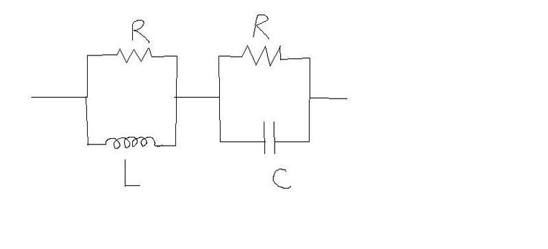

Two resistors, a capacitor, and an inductor are connected as shown. What is the frequency at which the impedance is purely real?
Diagram below
Inductor: Z = jwL
Capacitor: Z = [tex]\frac{1}{jwL}=\frac{-j}{wC}[/tex]
Resistor Z = R
I added all the components, but I don't see how I can get very far without any values of them.
[tex]\frac{1}{\frac{1}{R}+\frac{1}{L}}+\frac{1}{\frac{1}{R}+jwC}[/tex]
I'm not sure if the capacitor was added correctly, but that's just taken from my notes.
So is that equation I found equal to Z?
I need to set Im[Z] = 0, which is the imaginary part of the impedance, and then solve for w. Did I find Z correctly? And how do I know the imaginary part of Z?

The impedance of the inductor should involve jω. Your equation shows only L. Otherwise it looks okay.
You will need to separate the expression into real and imaginary parts (algebraically).

Yes, that's an expression for ##Z_{eq}##. It's not j that you want to solve for. You want to rearrange the expression so that it is put into the form ##Z_{eq} = A + jB##, where A and B are real expressions. In other words, separate the impedance expression into separate real and imaginary parts. Then work out what value of ω will make the imaginary part zero.

Can you expand upon how you arrived at that expression for the impedance?
Yeah, I'm not even sure if I can do that. I inverted both sides of the equation to get rid of the numerator on the right, then I combined the resistance terms, and then flipped it again to get rid of the numerator on the left.

It looks like the way you performed the inversion was not correct.
Invert the two principal terms separately and massage them into canonical form (a + jb) before attempting to add them (or extracting their imaginary parts for addition).

Yeah, it can get a bit messy and tedious working with complex algebra. But it's what has to be done here.
Start with just one of the main terms, say the inductor in parallel with the resistor and see if you can simplify it into the normalized form. You can use the "two resistor expression" for parallel resistors to begin if you wish:
$$z1 = \frac{R \cdot jωL}{R + jωL}$$
Clear the imaginary from the denominator.
Then do the same thing for the other, capacitor term.

Yes, the terms with j multiplying them are imaginary. j is the variable name associated with ##\sqrt{-1}##. j can "disappear" if it is multiplied by j (so it's squared) as j2 = -1.
It sounds like you should take a few minutes to review the properties and basic manipulations of imaginary numbers.

The last expression is finding the magnitude of the complex expression. The real and imaginary parts add in quadrature (square root of sum of squares). This is a property of imaginary numbers that you need to know.
I also don't understand how that j was factored out in the 1st one.
Multiply the numerator and denomination of the 1/(jωL) term by j.

The calculation is simpler if you make the denominators real, by multiplying both the numerator and the denominator by the complex conjugate of the denominator.
The RL part becomes
[tex]Z_{RL}= \frac {1}{\frac{1}{R}+ \frac{1}{jwL} }=\frac{\frac{1}{R}-\frac{1}{jwL}}{(\frac{1}{R}+\frac{1}{jwL})(\frac{1}{R}-\frac{1}{jwL})}=\frac{\frac{1}{R}-\frac{1}{jwL}}{(\frac{1}{R})^2+(\frac{1}{wL})^2}[/tex]
Decomposing into real and imaginary terms, the RL term of the impedance is
[tex]Z_{RL}=\frac{\frac{1}{R}}{(\frac{1}{R})^2+(\frac{1}{wL})^2}+j\frac{\frac{1}{wL}}{(\frac{1}{R})^2 + ( \frac{1}{wL} )^2 }[/tex]
Do the same with the capacitor term. Simplify, add the imaginary parts and make the sum zero.
