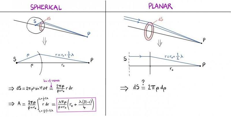

Hi everybody! I'd like to ask you guys some details about the following problem:
Determine the area of the l-th Fresnel zone of a planar wavefront considered from a point P. Give the numerical result for the 1st Fresnel zone for a wavelength ##\lambda=600##nm and a distance wavefront-P of ##0.5##m. How big is the error, if the term proportional to ##\lambda^2## would be removed?
Hint: use the result from the previous problem by changing it from a spherical to a planar wavefront.
The previous problem mentioned in the hint was about determining the area of the l-th Fresnel zone for a spherical wave. Integration gave me the result ##A_l = \frac{\lambda \pi \rho}{\rho + r_0} \big(r_0 + \frac{(2l - 1) \lambda}{4}\big)## and I concluded that the ratio ##A_l/r_l## is independent of l (where ##r_l## is the average distance to P from the Fresnel zone).
I am stuck right at the beginning because I am not really sure how to "change" ##A_l## for a planar wavefront situation. When I look at the elements of:
##A_l = \frac{\lambda \pi \rho}{\rho + r_0} \big(r_0 + \frac{(2l - 1) \lambda}{4}\big)##,
I see the following:
- the denominator ##\rho + r_0## refers to the distance between the source and the observation point. This stays the same with a planar wavefront I believe;
- the ##\pi## element comes from having a "ring" on the sphere. But I think this element also stays since the Fresnel zones are still rings for a planar wavefront (right?);
- ##\rho## was constant for a spherical wave, and it remains constant for a planar wavefront if we consider it to be the distance between the wavefront and the source (a plane). However the distance (say ##x##) to a theoretical source point (so that the distance between S on the source plane and P would be minimal) would not be constant anymore. Using the law of cosines as I did for the previous problem, I find the expression ##r^2 = x^2 + (\rho + r_0)^2 - 2 x (\rho + r_o) \cos \varphi## but it does not really take me anywhere I'm afraid.
I must be thinking something wrong, or misunderstanding the "hint". Do you guys have another hint? :biggrin:
Thank you in advance for your answer, I'm looking forward to reading them.Julien.
One idea I just had would be to take the expression ##\frac{A_l}{r_l} = \frac{\lambda \pi \rho}{\rho + r_0}## which should hold for a planar wavefront since ##r_l = r_0 + \frac{(2l-1) \lambda}{4}## is independent of ##\rho##. Then the rest of the work would be to find an expression for ##\rho## corresponding to a planar wavefront, in which I am unsuccessful so far. Does that make sense though?

Hi again @Charles Link and thank you for answering me again! I've actually seen that interpretation of the Fresnel zones (circular rings on a flat plane) several times while searching on the internet. However the surface I considered in the previous problem was curved. I've attached a picture to make every step clearer (and maybe my confusion as well!).
Note: in the planar section ##\rho## refers to the radius of the circle.

I think the planar case is actually simpler. The phasor diagram for each of the zones is then precisely a semi-circle, apart from an obliquity factor (e.g. ## cos(\theta) ## is often used.) ## \\ ## editing: Each area element ## dA ## contributes an arc length ## ds ## to the phasor diagram. When ## d \phi / ds ## is constant, it becomes a circle with ## d \phi/ds=1/r ##. I calculated this a few years ago, but I remember the result and it should be easy enough to repeat the calculation, if necessary.

Note: I've been starting this post before your last post, so I'm going to try with ##\theta## now. Does it refer to the angle between the optical axis and ##r## in my drawings?Julien.
Please read my edited version of post #5.

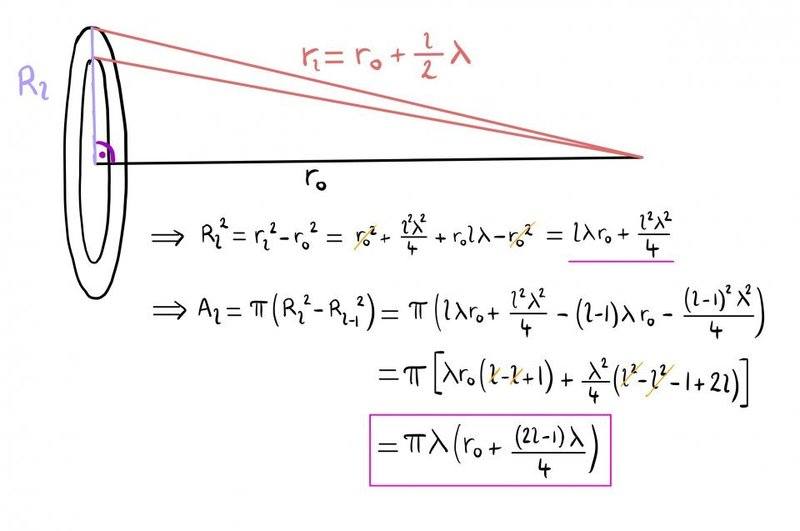

I've performed a new calculation which includes 2nd order terms (and l) which is (maybe) both coherent with my previous answer and with the problem (which mentions a 2nd order term). I'm now getting:
##A_l = \pi \lambda \big(r_0 + \frac{(2l-1) \lambda}{4} \big)##
I've attached a picture detailing my calculations and with a picture. I haven't used the obliquity factor though. Do you think it is correct?

Julien, Your result of post #10 looks good to me. How does this result compare to the spherical case in the limit ρ → ∞?
@TSny Yes it is the same... I didn't really consider the planar wavefront as a spherical wavefront from far away, I've realized that in between. Thanks for pointing that out.Julien.
