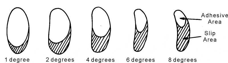

When the tire is slipping, part of the tire patch is static (no motion with respect to the ground) and part is kinetic (sliding on the ground). The higher the slip ratio, the larger the kinetic portion of the tire patch. The following is for lateral forces but the same concept applies to longitudinal forces:
http://www.insideracingtechnology.com/tirebkexerpt2.htm said:
At higher slip angles portions of the tire patch are sliding, and you get less increase in lateral force with an increase of slip angle. This is called the transition region. As the curve tops out, more of the contact patch is sliding and the tire produces less lateral force. After the peak of the curve, lateral force can fall off 30% within a few degrees of extra slip angle. At these high slip angles most of the contact patch is sliding, producing a lot of heat and wear.
Five outlines of a tire contact patch at 1, 2, 4, 6 and 8 degrees, each with diagonal hatching marking the slip area and the rest labelled adhesive area; the slip area grows with angle.
By the "adhesive" area, one should read the "static" area, and by the "slip" area one should read the "kinetic" area.

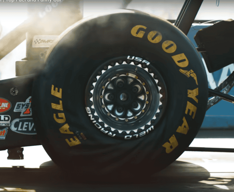

Here is an image of a tire accelerating. The vehicle goes towards the left with the wheel rotating counterclockwise. Notice how the rubber is "pushed" in front and "pulled" in the back:

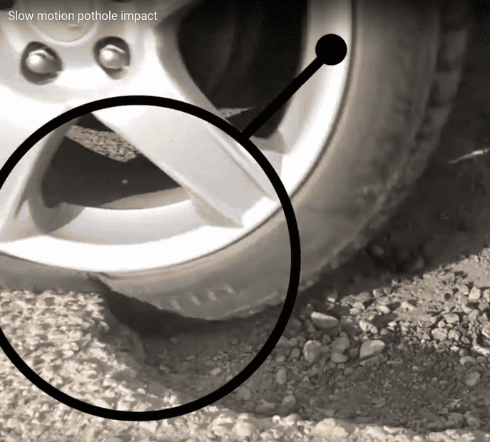

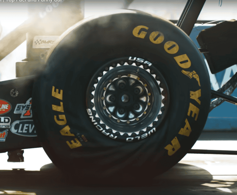

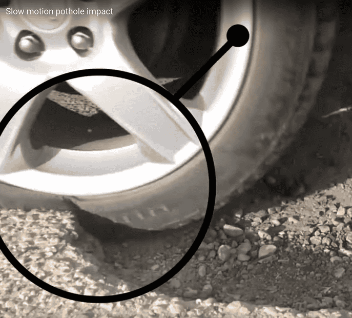

It is more difficult to find a wheel braking where the tire deformation is so obvious but in the following image, you can see the deceleration induced by a pothole. The vehicle is still going towards the left with its wheel rotating counterclockwise. But now the rubber is "pulled" in front and it is "pushed" in the back:
Slow-motion still of a car wheel with a silver multi-spoke alloy rim striking a gravel pothole, with a black circle magnifying the tyre contact patch where the rubber deforms.

So, the same direction of rotation but opposite twisting torques are applied.
