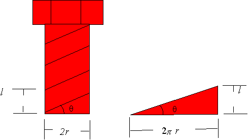

Could you do a simple wedge calculation disregarding friction, which is the maximum clamping force possible?
Your mechanical advantage should be π x diameter / pitch.
Please, see:
http://emweb.unl.edu/negahban/em223/note16/note16.htm
Hi Lnewqban, thank you for your reply.
The force applied at the edge of a 3/8-16 bolt due to an applied torque of 25 ft. lb. is:
Ft = T / r
where,
  • Ft = The force tangential to the bolt's threads in pounds resulting from the applied torque.
  • T = The applied torque in ft. lb.
  • r = radius of bolt in feet.
Calculation:
Ft = 25 ft lb / (0.375 in./2 * 1 ft./12 in.) = 1600 lb
The mechanical advantage is calculated as follows:
MA = π * D / P
where,
  • MA = The mechanical advantage
  • D = The thread diameter of the bolt in inches.
  • P = The thread pitch of the bolt in inches.
Calculation:
MA = π * 0.375 in / (1/16 in) = 18.85
The axial force on the bolt (ignoring friction) is calculated as follows:
Fa = MA * Ft
where,
Fa = The axial force on the bolt in pounds.
MA = The mechanical advantage.
Ft = The force tangential to the bolt threads in pounds.
Calculation:
Fa = 18.85 * 1600 lb = 30,160 lb
I found this article that indicates that only ~10% of the applied torque results in bolt tension. The rest is consumed by friction. Using this fact, I can attempt to take friction into account.
Recalculating the axial tension force.
Ft = (0.1 * 25 ft lb) / (0.375 in. / 2)(1 ft / 12 in) = 160 lb
Fa = 18.85 * 160 lb = 3,016 lb
The result is significantly lower than the 4000 lbs. I calculated previously, but it is still close to the ultimate tension spec. value of 3480.

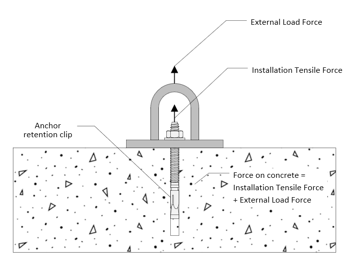

The installation tensile force is the force of the nut clamping the object being clamped to the concrete. Since the clamping force is only pulling the object against the concrete, it is not trying to pull out a concrete cone. The installation tensile force needs to be greater than the maximum external force applied to that object. If the installation tensile force was less than the external force, the object would pull free due to elastic strain in the bolt.
Hi jrmichler, thank you for your reply.
I am trying to understand what you are trying to convey here. Per my understanding, the installation tensile force is required to wedge (i.e., compress) the anchors retention clip against the wall of the concrete hole. The resulting compressive force increases the friction between the anchors retention clip and the wall of the concrete hole. It is this frictional force that will oppose the installation tensile force, as well as any applied external force pulling axially on the anchor. Ultimately, the concrete must bear the entire axial load of the anchor, i.e., the installation tensile force plus any external axial load placed on the anchor. See Figure 1 below.
It seems to me that any axial tension force, as long as it's not too sudden, will act to wedge the anchor's retention clip against the wall of the concrete hole. Consequently, it shouldn't matter whether the axial tension force is created by the external load force or by torquing on the anchor nut.
I can understand the need to initially apply the installation tensile force by torquing the anchor nut to the specified installation torque, but after doing so, it seems that the anchor nut torque should be adjusted so that it only applies enough clamping force to securely attached the fixture to the concrete. A reduction in the axial tension force introducted by torquing the anchor nut, will allow for a larger external axial load force to be applied.
Figure 1: Force on the concrete
All that being said, I still don't understand why my calculated installation tensile force is greater than the ultimate tensile force of the anchor. I emailed the manufacture and their initial response was very vague. I responded asking if they would provide me the range of possible installation tensile force values that could occur when the installation torque value of 25 ft. lbs. is applied.

It seems that the flange (bottom plate) of the fixture is distributing the force of bolt tension at the concrete surface; thus the installation torque has no effect on the extraction (concrete failure) from an externally applied load.
Cheers,
Tom
(A case of a picture is worth a thousand words?)

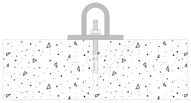

Hi Tom.G, thank you for your reply.
Here is my hypothesis.
First, assume there is no external load force. Tightening the anchor nut will force the anchor clip against the concrete. The resulting friction prevents the anchor from sliding out of the anchor hole. As the anchor nut is tightened, the stress in the concrete and the anchor increase. The concrete experiences stress at two places: where the anchor clip engages the concrete and where the fixture engages the concrete. See Figure 1.
Figure 1: Forces due to tightening anchor nut
If more and more torque is applied to the anchor nut, either the anchor or concrete will fail. One possibility is that the anchor begins to deform plastically and finally snaps. Another possibility is that the concrete cracks allowing the anchor to slide within the anchor hole. See Figure 2. These are only two of many failure modes.
Figure 2: Anchor clip slides in hole due to crack
Second, let’s say the anchor nut is not tightened to the point of failure, but close. If an external tensile force is added, the concrete and anchor will experience more stress. The concrete will experience more stress at the anchor clip boundary. The anchor will experience more tensile stress. See Figure 3.
Figure 3: Forces due to anchor nut tightening plus external force on fixture
In this case, the lateral forces in the concrete at the anchor clip will be larger due to the additional tension force on the anchor. I'm thinking the larger lateral forces may play a role in the concrete cracking and the anchor being pulled out.
Could be. My comments were aimed more at the conical failure pull-out discussion. That part of the conversation was considering that the bolt tightening tension was directly added to any vertical extraction loading.
What prompted me to examine the Red Head Trubolt anchor specification was my desire to know how much clamping force would be applied to a fixture when the anchor installation torque was applied. I need to design a wedge shim to allow a railing post to be installed on a 11° ramp. One idea is to cast the wedges from polyurethane. I wanted to know the clamping force of the anchors so I could calculate how much compression force the polyurethane wedges would be subjected to.
