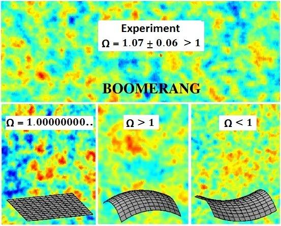

We still have to face the question of how in heaven charting the size-dstribution of these acoustic peaks enabled people to deduce something about the geometry of the universe.
This graphic helps one grasp how they deduce curvature from the skymap of CMB fluctuations:
http://cmb.phys.cwru.edu/boomerang/press_images/raw_images/model_maps.jpg
Cepheid found the link.
A new member Jerusalem brought in the picture but without a link. I will copy Jerusalem's picture:
If we believe the confidence interval on this picture, Boomerang found Omega to be in the range [1.01, 1.13].
By modern standards this is WRONG. The 2010 WMAP report, the final report based on 7 years of data, gave the 95% confidence interval as [0.9916, 1.0133].
So it now includes Omega = 1 (exactly flat, zero overall curvature)
and it even includes a little territory < 1 (negative curvature, fluctuations look SMALLER than actual size)
I guess most people realize that this is where the issue is to be settled whether the standard LCDM universe is more likely finite spatial volume or more likely infinite volume with infinite amount of matter all existing simultaneously.
