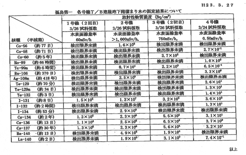

Here is further analysis of water in buildings #s 1, 2, 3 originally posted by Antoni in post #1428 of main thread.
https://www.physicsforums.com/attachment.php?attachmentid=33592&d=1301197946
Note the ">1000 mSv/hr" at top of column for water in building #2 . Based on ratio of cesium isotopes, may actually be higher.
Revised numbers for #2 reported by Pietkuip (post # 1576) in main thread.
http://www.tepco.co.jp/cc/press/betu11_j/images/110327o.pdf
(in English)
http://www.tepco.co.jp/en/press/corp-com/release/betu11_e/images/110327e15.pdf
