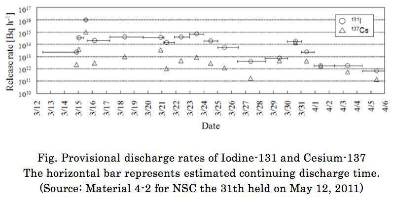

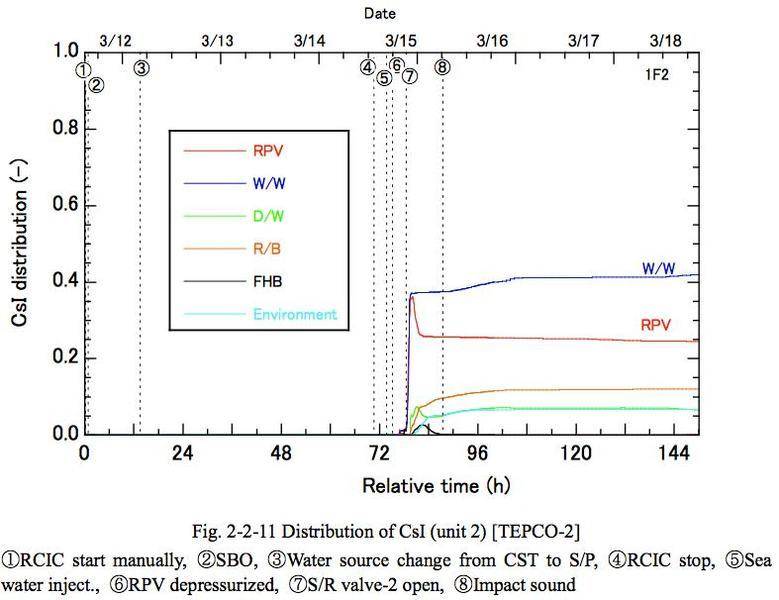

Im stilla bit confused about the exact timing of the release to the environment, because cetain graphs that I posted in the main thread just the other day, seem to suggest that a lot of stuff got into the environment in the hours leading up to the explosion, rather than after the explosion. Thats what their reactor analysis seems to show. But other analysis, based on radiation readings at certain locations on site, seems to have the highest magnitude releases happening after the explosion.
First graph shows stuff going into environment after valve opened, before explosion.
https://www.physicsforums.com/attachment.php?attachmentid=36458&d=1308073787
This graph of estimated total release amounts and the time periods they cover, has highest magnitude releases happening for just a few hours during the 15th, at a time after the explosion:
https://www.physicsforums.com/attachment.php?attachmentid=36462&d=1308080200
I'm going to respond to a few things that were said in main thread recently, but as they involve release issues with reactor 2 I'll do it here.
MadderDoc said:
Those figures appear to be the results of a modelling attempt based on a selected subset of possible scenarios, and not based on actual release measurements. You cannot base such a strong statement on that.
I need to work harder on translating this document, which explains how release estimates were calculated:
http://www.nsc.go.jp/anzen/shidai/genan2011/genan031/siryo4-2.pdf
From what I can tell they did use actual sampling of conditions outside the plant, they were not just relying on other analysis of what may have happened at the reactors.
However there certainly seems to be a reason to have some doubts about the very highest magnitude release estimates from unit 2. From the table on page 4 of the document, we can see that for the time period of the highest estimated releases, 9am to 3pm on the 15th, they had to rely on air sampling only, they did not have any dust sampling data. I believe this is due to the weather conditions of the 15th, I think dust sampling method doesn't work when its raining/snowing.

That TEPCO data & post you link to are about the first hour or so after the earthquake hit. For a guide to what may have happened on the 14th and 15th, I use some other TEPCO & NISAs analysis, mostly via the english version of report to IAEA.
http://www.kantei.go.jp/foreign/kan/topics/201106/pdf/attach_04_1.pdf
Table on page 23 of Attachment IV-1 tells us:
9.20pm on 14th they open 2 SRV's and reactor pressure decreases.
11pm it is presumed that the 1 SRV was closed because reactor pressure increased.
The 2nd graph on page 35 shows these reactor pressure trends.
Graphs on page 36 show the D/W and S/C pressures, both measured and those predicted by the model. Note that S/C pressure readings start to go down well before the explosion, at a time when D/W pressure readings are going up.
Graph on page 32 of the document shows us the reason they have also assumed a D/W leak really early on, approx 21 hours after earthquake. This version of graph does not factor in this assumption, and as a result the model says that D/W and S/C pressures would have gone shooting up to very high levels days earlier. The other graphs I already mention do have the assumption of 21 hour D/W damage in them, and as a result the model D/W and S/C pressure values track the ones they actually measured pretty well.
Note that I have chosen analysis case 2 because that's the one that reflects what they learned about bad water level readings at reactor 1, implying less water at the other reactors. This leads to conclusions such as RPV damage having happened. Case 1 was the more optimistic version of events where fuel was only partially melted and RPV damage didnt happen, so I've paid much less attention to it.
Also note that this document is TEPCOs version of analysis, and their versions of the FP existence ratio graphs are not like the ones I posted recently, theirs have only around 1% of stuff getting outside containment.
Assuming both analyses represent reality, it would seem to imply that (some) radioactivity was released from unit 2 before the explosion in the unit (due to venting), and quite a lot more radioactivity was released after the explosion in unit2 -- however not from unit 2 but from one or more of the other units.
