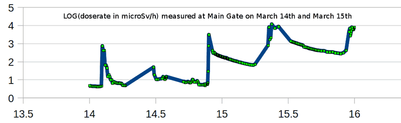

Forgive me, but how does anyone know how much radioactivity came from each building?
  • #74
Excellent question. I was asking myself the same thing. But apparently, TEPCO knows. Or they think they know. There's a detailed listing of how much radiation every building spew:
http://www.kantei.go.jp/foreign/kan/topics/201106/pdf/attach_04_2.pdf
Check out page seven.
(Though it's probably outdated by now... recent publications give much higher numbers for the total released quantity of Cs)

  • #76
Well sadly that report does not go into much detail about how they did calculations etc.
Certainly we should still be careful when comparing the reactors, because nobody really knows and there are a number of factors which can have a very large impact on estimates:
The assumption that reactor 2 suppression chamber sustained damage can make a big difference to release estimates, and although TEPCO said explosion wasn't there, damage cannot be ruled out yet. Probably safe to assume that most release estimates still involve assumption of s/c damage at reactor 2.
Possible very brief factor 2 drywell vent that we don't know whether actually happened or not (at 0:02 on 15th).
The wind was blowing out to sea during key big events for reactor 3, so it would be easier to underestimate this reactors releases.
Later events at reactor 3 might be hard to distinguish from events at reactor 2, and we hear little of events that happened after the 16th.So with this in mind, it is probably safer to say the following, as opposed to saying that reactor 2 released more in total. Reactor 2 was responsible for the majority of the contamination on land, because of timing of wind and rain. And because of the highly contaminated water int he basement and the leaking of some of this to the ocean, we can blame reactor 2 for a lot of the ocean contamination too. But reactor 3 could have released a lot into the air over the sea, and may have contributed to some of the march 15th-16th and 20th land contamination that's mostly blamed on reactor 2.
While the French report is lacking in some areas, I think it is very very good for looking at the detail of what the weather was doing at key moments, and the land contamination data.
As to why it labels an event of a graph as being caused by reactor 2 venting at approx 9pm on the 12th, this looks like a simple mistake to me but I shall go and check other sources to remind myself what event actually happened at that time.

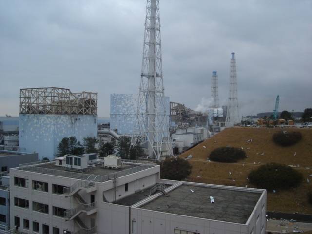

SteveElbows said:
What I find especially annoying is that we don't even know exactly when steam was first noticed to be coming from the blowout panel hole in the side of reactor 2. We certainly know that plenty of steam etc came out of this hole later, as we have footage, but not knowing when it began is frustrating. Assuming it was from the reactor rather than the fuel pool, which is a reasonable bet given much later footage showing steam from the reactor arena and the robot-measured radiation readings showing high levels by one side of the floor above the reactor well, we may well imagine that this started on March 15th. But it would be good to know for sure, especially as events at reactor 4 building on the 15th also got in the way of really clear explanations of radiation data on that day.
http://www.tepco.co.jp/en/news/110311/images/110412_1f_tsunami_6.jpg (This is the earliest dated photo I know of showing steam coming from Unit 2.)
  • #78
Wow! I had missed that one when it was originally released as Tepco published it last April in reference to tsunami water levels, I had not considered the possibility that the photo was taken on a crucial day of the unfolding disaster.
If the timestamp is accurate then this photo was taken during the period when the reactor 2 drywell pressure was falling substantially, and a time when large number of people had been evacuated from the site. Hardly the time that you would choose to send people to take photos relating to the tsunami, but certainly a time where you may want photo of what's happening at reactor 2.
I didn't find other photos taken with the same camera, so its hard to find evidence that the time & date were correct. I note that the photos taken from the ground that show reactor 4 damage were taken with a different camera approximately one hour earlier (if this other cameras timestamp is accurate).
  • #79
A _third_ camera was according to exif data involved in the taking of the photo at
http://www.tepco.co.jp/en/news/110311/images/110412_1f_tsunami_5.jpg.
According to its exif data this photo was taken about 10 minutes before the photo showing steam from unit 2, and the camera was pointed west, from 100 m down the road between units 2 and 3, i.e. pointed towards the position from which the steam photo according to its exif data was taken a few minutes later.
Judging from details shown in this photo (e.g the presence of particular pieces of debris, that were later removed, and the absence of hoses laid out later,) this photo must have been taken quite soon after the explosion in unit 3, so I am rather confident that the exif date of this photo is correct.
And albeit indirectly, this would support that the Unit 2 steam photo was in fact taken on the morning of March 15, along with other photos, apparently by a 2+ camera/man expedition.

The explosive sound was heard at 06:10 on 15 March 2011.
Almost at the same time, unit 2's suppression chamber pressure reading declined to 0 Pa, which is below atmospheric pressure.
The radiation rose to 15 mSv/hour at the main gate at 9 AM on 15 March 2011.
Tepco's nuclear safety group manager Koichi Miyada said that unit 2's PCV pressure declined from 730 kPa at 7 AM on 15 March 2011 to 150 kPa at 11 AM, and "it is inferred that at this stage, large quantities of radioactive substances were released". "(as the S/C pressure reading below atmospheric pressure is hard to believe) there is a high probability that the measuring instrument is broken".
