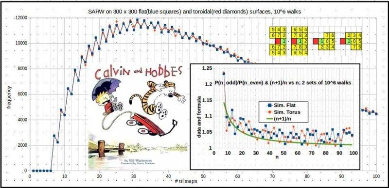

mfb - Again many thanks for taking an interest in this problem. The wheels in my 82 year old head don't spin as fast as they once did! Your values for the probabilities, P(7) and P(8), of 7 and 8 step walks agree well with two 1-million walk simulation runs;
P(7)=6/3^7 Run 1 Run 2
0.002743 0.002755 0.002791
P(8)=5/3^7
0.002286 0.002237 0.002258
I think I understand 6/3^7; each step has 3 branches so in 7 steps there are 3^7 possible walks, and for each of the 3 branches there is a left- and a right-handed trapped loop making 6 successes. (Since trapping involves a curling path, is it so that all trapped walks come in left- and right-hand pairs?)
Attempting to use the previous reasoning for the 8 step walk leads me to this (wrong) conclusion: 3 branches for 8 steps gives 3^8 walks, for each branch there is the same, left/right pair of 7-step trapped loops, but with two possible additional first steps for a total of 12 successful 8-step walks. That gives me 12/3^8 = 4/3^7 instead of your 5/3^7. I have spent many waking and even dreaming hours trying to understand why 4 must be 5! I'm sure I'm missing something that should be obvious, but would be grateful for your explanation!
I suppose, more accurately, the 8-step probability should be reduced by multiplying by the probability of not being trapped at 7 steps: 1-P(7) = 0.99726, but it would take a simulation of about 50 million walks to verify that, and much confidence in the random number generator!
I start all walks with the same [1,0] step since symmetry suggests that this should have no effect on the distribution of walk lengths, and it will allow me to see what effect this bias might have on final displacement.
The trend of your (n+1)/2, N/2 parity effect is evident in the data, but apparently an underestimate.
I have a figure summarizing what I have said, but not sure whether it has uploaded.

The probabilities are absolute. If we would have those values for all N, they would add to 1.
The 8-step path has a tricky case: if you go NNWWSSE (using the directions as you would expect), there are just two instead of three options left for step number 8, one of them ends.
Define North to be the direction of the first step.
- With 1/3 probability the next step is also N, then we have 2/3 probability to go E or W, afterwards we have to choose the right direction out of 3 four times in a row, and finally a 1/2 chance to get trapped. Total: 1/36 = 3/37
- With a 2/3 probability the next step is W or E, then the next 6 steps have to pick the right direction out of 3, for a total contribution of 2/37.
Sum: 5/37
The 7-step walk has 1 case, the 8-step walk has 2 cases, the 9-step walk has 6 cases, and the 10-step walk has at least 15 cases. Manual analysis becomes messy quickly.

That (n+1)/2 vs n/2 pattern should have an odd/even pattern.

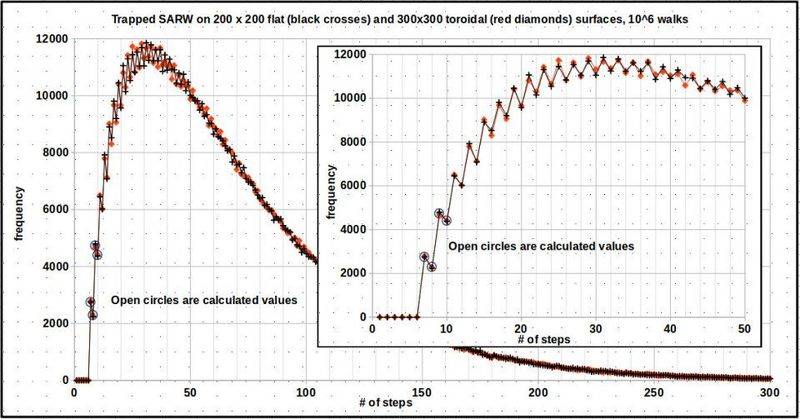

Thank you for explaining how to count the probabilities for each path of a random walk! And for soothing my pride with the word “tricky”.
I have found six 9-step trapped walk paths that end next to the starting square. Together with their mirror images that makes twelve. I also found four 9-step paths that end a knight’s move from the starting square and one that ends three steps from the starting square in the direction of the first step. With their mirror images that brings the total number of 9-step paths to 22. I have worked out the probabilities for the 9-step walks and they check nicely with my simulation.
That led me to try the 10-step case where I found 25 paths with their mirror images to make 50 total. Again, the calculated and simulated results agree; see attached graph.
https://physicsforums-bernhardtmediall.netdna-ssl.com/data/attachments/90/90305-8f8dc085dc1cb941a4f653baea3f44e9.jpg
I found at least 190 different 11-step trapped walk paths (including symmetric ones) in a sample of 10^6 walks. The samples of 11-step paths ranged in size from 93 down to 10.
I have a copy of “The Self-Avoiding Walk” by Madras and Slade on order in hopes it may provide further insight into this system.

If we define the first step to be North, we have 10 steps left for the 11-step walk, removing the mirror symmetry each path has a probability of at least 2/3^10 or 1 in 30,000. With an expected occurrence of 30 or more in a million samples, it is extremely unlikely that you missed any pattern. It should be possible to automatically analyze those patterns in terms of the number of available spaces in each move, which leads to the probability of this path.
With a back-tracking algorithm, it should be possible to list all cases (less than 30,000) and their probabilities. The less than 1 million cases for 14 steps should still work, afterwards it might need some computing time. n steps in a self-trapping walk need at most n-5 empty space in every direction from the starting point, but grid size should not be a limit anyway.
