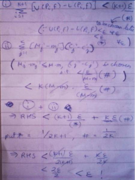

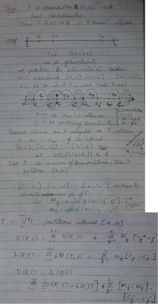

to prove that a function bounded on [a,b] with finite discontinuities is Riemann integrable on [a,b]
if f is R-integrable on [a,b], then [itex]\forall[/itex] [itex]\epsilon[/itex] > 0 [itex]\exists[/itex] a partition P of [a,b] such that U(P,f)-L(P,f)<[itex]\epsilon[/itex]
the term on the LHS must be made <ε
Handwritten notes proving a bounded function with finite discontinuities is Riemann integrable: a number line partitioned at points c1, c2 and ck, then a partition of [a,b] with subintervals and upper and lower sums U(P,f) and L(P,f) written out.
You're almost there! You can choose your c_j'' and c_j' to be as close as you want, can't you?
make it small enough to neglect the second term on the RHS?
Thats the idea. You can choose c_j''-c_j' to be less than some multiple of epsilon and then proceed.
