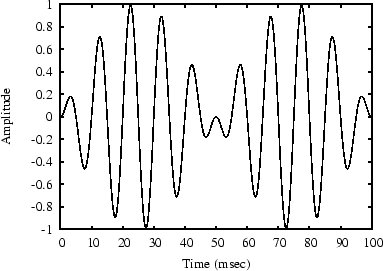

Hi;
This is in fact not a homework question, but it rather comes out of personal curiosity.
If you look at the graph of the two functions in the image attached, what is the simplest functional representation for such a symmetrical pattern?

They look like ##x \sin(\omega x)##, which I see you have indicated already. What is wrong with that?
Hi @haruspex,
It actually works, but only for positive x. For negative x, I want to see it mirrored, and in addition I would like to avoid using abs or conditionals in the function.

It’s actually my plot, so there’s no link. It’s the result of an evolutionary algorithm for a specific problem , where I consistently get such graphs. Since I’m not a physicist, I wanted to consult if there is any simple function representation that fits the shape.
How about ##x^2 \sin x##?

What is the difference between the two plots? Did you just squeeze the horizontal axis to make the 2nd plot?
Also, it looks a lot like an AM modulated sine wave to me...
Good point.. it is not ##x \sin (x)## since that is an even function whereas the graphs show an odd function. But whether the peaks show a quadratic behaviour is unclear. Could be something like ##x^{\frac 23} \sin (x)##

Thanks @vela, that’s pretty close but when plotted, it doesn’t cut the origin like a diagonal as in the two sample graphs, but rather becomes tangent. But that’s a nice clue.
You want an odd function, so try ##x \cos x##.

great, I think this really looks the same! thanks a lot!

Do you have the curves as datapoints? If you figure out the frequency (looks sort of constant) you could divide by ## \sin(\omega x)## and try to fit the resulting curve.

Actually since the x-axis (the domain of the function) is also subject to evolution, the result may come in different shapes. But you can take only one of them as reference. However, as @vela stated, xcos(x) works quite well, I guess this is the function that I was looking for.
