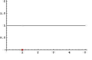

Oh, I've took your advise, and let me show that to you graphically (attached).Now the red graph (it's supposed to have a branch on the left too)
If I'd simply defined it with
<br /> F(x)=\frac{|2x-3|x(x-3)}{2x-3}<br />
But the blue graph is what would happen if I'd played with constants a little bit and would define like that:
<br /> F(x)=x(x-3); x&lt;3/2<br />
<br /> F(x)=-x(x-3)+4.5; x&gt;3/2
You see, F is still an anti-derivative, yet now it's also continuous.
