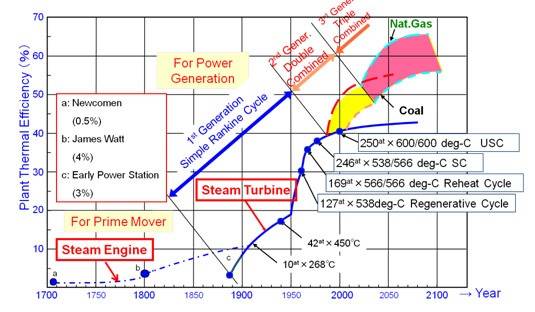

Progress more realistically:
Fuel efficiency:
Thermal power plants:
(I picked up those indicators, because I could easily found data)

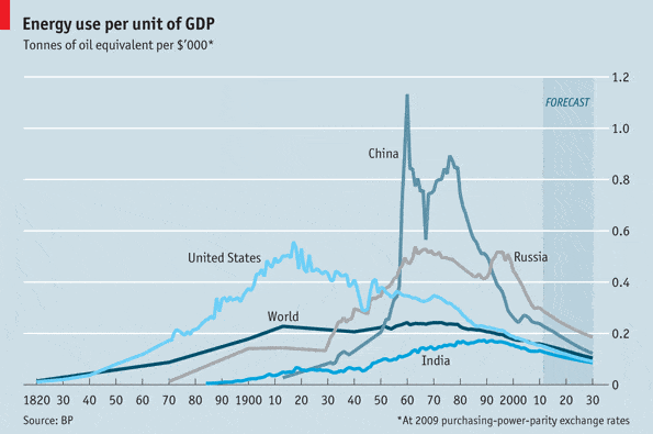

It seems that energy plays a very important role in civilization.
I'd just say, that in last years development looked in the following way:
-you use roughly the same amount of energy;
-thanks to using it more efficiently you produce higher GDP.

Wow, what a nice graph you send me. Thanks.
Czcibor said:
Yes, yes. I just remember that the name sounds like Kim Kardashian, but forget the actual name is.
There's a peak in US graph in 1970's for oil needs but descends later. Why is that? Fission plant?
They say France is 100% fission dependent, yet the oil needs do not descend. Why is that? Transportation?
https://en.wikipedia.org/wiki/1973_oil_crisis
USA supported (saved?) Israel during Yom Kippur War, so Arab countries retaliated by slashing production to increase prices.
Later - better technologies and regulations intended to stop CO2 emissions.
My guess is that anyway, regardless of politics the economy would become more fuel efficient, just the demand for energy would not be just flat.
France? Political decision. Plus I think that they had their own nuclear program that was dreamt to stop communist single-handed helped to provide technology and enough engineers.
