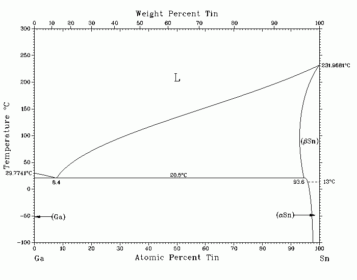

I had a look through that site and found this graph for Ga: Sn:
Gallium-tin binary phase diagram plotting temperature in °C against atomic percent tin, with weight percent tin on the top axis; liquid region L above a eutectic at 20.5°C near 8.4 and 93.6 atomic percent tin.
Am I correct that the angled line represents the melting point (going entirely off of logic, as it links pure galliums melting point to pure tins meltipng point)? If so, it looks like 18% tin will be about the right combination to achieve a circa 40°C melt temperature. Am I reading this correctly?
The L in the diagram represents the liquid phase. The point at 8.4% Sn is the eutectic point (lowest possible melting point for a Ga:Sn combination). But I’m not seeing why you think 18% Sn will give you a melting point of 40C. It looks closer to 60-70C with my eyes.
Note different scales at bottom and top. Ga and Sn have different atomic masses, and thus atomic and weight percentages differ. The atomic percentage is shown at bottom (and is presented as linear), the weight percentage at top (nonlinear).
But the upper line is the liquidus line. Below that line, to solidus line, two phases - liquid and solid - coexist.
This means that a Ga-Sn alloy, so long as the Ga content exceeds the solid solubility of Ga in Sn (6,4 atom %) will partially melt at 20,5 Celsius, separating into the Ga-Sn melt (initially 8,4 atom % Sn) and impure solid Sn (initially 6,4 atom % Ga). As the melt is warmed in contact with the solid, more Sn dissolves into the melt so the Sn concentration in melt increases. It looks a plausible reading that at 40 C, the saturated solution of Sn in Ga is 18 weight % Sn.

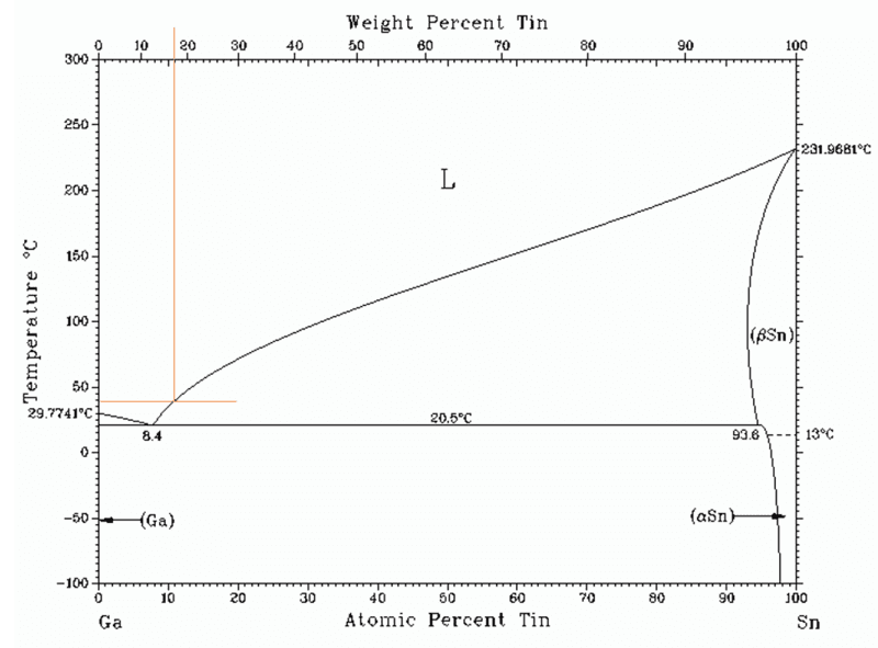

I was going by weight, as that is what I will be able to work with easiest for my backyard experiments!
Gallium-tin binary phase diagram plotting temperature in °C against atomic percent tin, with weight percent tin on the top axis; a liquid region L sits above the liquidus curves, with a eutectic near 20.5°C at 8.4 and 93.8 atomic percent tin, and orange guide lines marking about 17 weight percent tin.
It's hard to gauge because of the irregular tickmarks & the resolution of the image but it looks like 16-18% by weight should get somewhere in the right region - from there I can go for trial & error!
Next step is research on making an alloy - I think it's a case of heating Gallium to over the melting point of tin, mixing the two thoroughly so the tin dissolves, and then allowing it to cool - but I will go for a bit more research before I actually do it!

Think of it as dissolving a substance (tin) in a solvent (gallium). You don't need to heat the gallium much to make it liquid, and then adding the tin slowly to allow it to dissolve should be fine. An (oversimplified) analogy would be dissolving salt in water - you'd add the solid salt, not molten salt.
Not sure if there's any issue with tin having an oxide layer through passivation - maybe scratch the tin with a sharp knife just before putting into your gallium?
Looking at the graph with my old eyes, 40°C is at 12% atomic ratio Sn
$$\frac{0.12\times 118.7}{0.12\times 118.7+0.88\times 69.72}=0.188$$
...so 18.8% Sn by weight.
