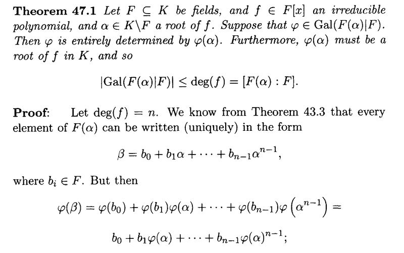

I am reading Anderson and Feil - A First Course in Abstract Algebra.
I am currently focused on Ch. 47: Galois Groups... ...
I need some help with an aspect of the proof of Theorem 47.1 ...
Theorem 47.1 and its proof read as follows:

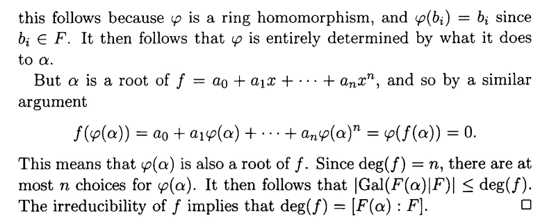

At the end of the above proof by Anderson and Feil, we read the following:
"... ... It then follows that ##| \text{Gal} ( F( \alpha ) | F ) | \le \text{deg}(f)##.
The irreducibility of ##f## implies that ##\text{deg}(f) = | F( \alpha ) : F |## ... ... "
Can someone please explain exactly why the irreducibility of ##f## implies that ##\text{deg}(f) = | F( \alpha ) : F |## ... ... ?Peter

What is ##|F(\alpha):F|##? Or better: how can it's value be determined given only ##\alpha## and ##F\,##?

Well ... ##|F(\alpha):F|## is the degree of the vector space ##F(\alpha)## over ##F## ...
To answer your second question ... the degree of ##F(\alpha)## over ##F## is equal to the degree of the minimal polynomial of ##\alpha## over ##F## ... and that minimal polynomial is the unique monic irreducible polynomial in ##F[x]## of minimal degree having ##\alpha## as a root ... ...
Is that correct?
Peter

Presumably, ##f## being an irreducible polynomial having ##\alpha## as a root means that ##f## is the minimum polynomial ...
BUT ...
... just thinking over how we know that there isn't an irreducible polynomial ##g## of lesser degree than ##f## having ##\alpha## as a root ... in which case ##g## would be the minimum polynomial, not ##f## ... how do we know that there is not such a polynomial ##g## ...
Yes, that's correct. ##m_{\alpha,F}(x)## is the polynomial which satisfies ##m_{\alpha,F}(\alpha)=0## and which has no factors ##f(x)## that also would satisfy ##f(\alpha)=0##. You can see it by division: ##f(x) = q(x)\cdot m_{\alpha,F}(x) +r(x)## and if ##f(\alpha)=0##, then ##r(\alpha)=0## with ##\operatorname{deg} r(x) < \operatorname{deg} m_{\alpha,F}(x)## which means ##m_{\alpha,F}(x)## wasn't minimal.
So what does the irreducibility of a polynomial ##f(x)## imply in the given situation?

"... ... So what does the irreducibility of a polynomial ##f(x)## imply in the given situation? ... ... "From what you have said ... it means that ##f## is the minimal polynomial ... and so then ... ##\text{deg}(f) = [ F( \alpha ) : F ]## ... ...
Is that correct ... ?
Peter
Yes, you can use the same argument. Since the remainder polynomial ##r(x)## would have a smaller degree than the minimal polynomial, ##r(x)## has to be the zero polynomial itself. But then ##f(x)=q(x)\cdot m_{\alpha,F}(x)## and irreducibility of ##f(x)## guarantees ##q(x)=q_0 \in F##. Whether ##f(x)## is the minimal polynomial depends on whether it is monic (highest coefficient ##= 1##) or not. It could well be a multiple of ##m_{\alpha,F}(x)## with a factor from ##F##. But this isn't important for the degree.

... how do we know that there is not such a polynomial ##g##.
There might be one, but then ##f(x)\,\vert \,g(x)##. And since ##f(x)## is irreducible, there cannot be any polynomial of smaller degree. It is always the division formula ##g=q\cdot m + r## which gives the argument.
