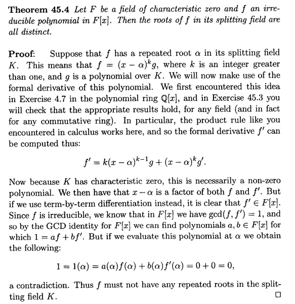

I am reading Anderson and Feil - A First Course in Abstract Algebra.
I am currently focused on Ch. 45: The Splitting Field ... ...
I need some help with some aspects of the proof of Theorem 45.4 ...
Theorem 45.4 and its proof read as follows:
My questions on the above proof are as follows:Question 1In the above text from Anderson and Feil we read the following:"... ... This means that ##f = ( x - \alpha)^k g##, where ##k## is an integer greater than ##1## and ##g## is a polynomial over ##K## ... ... Since ##f## is in ##F[x]## ... that is ##f## is over ##F## ... shouldn't ##g## be over ##F## not ##K##?
(I am assuming that ##f## being "over ##F##" means the coefficients of ##f## are in ##F## ... )
Question 2In the above text from Anderson and Feil we read the following:"... ... We then have that ##x - \alpha## is a factor of both ##f## and ##f'##. But if we use term-by-term differentiation instead, it is clear that ##f'\in F[x]##. ... ... "What do Anderson and Feil mean by term-by-term differentiation in this context ... ... and if they do use term-by-term differentiation (what ever they mean) how does this show that ##f'\in F[x]## ... ... ?
Hope someone can help ...

If ##\alpha\in K-F## then ##g## will not necessarily be in ##F## as its coefficients will be functions of ##\alpha##.
Consider ##F=\mathbb R,\ K=\mathbb C## and ##f(x)=(x^2+1)^2=(x-i)^2(x+i)^2##, which has roots ##i## and ##-i##, both of multiplicity 2. Taking ##\alpha=i## we get ##g(x)=(x+i)^2##, which is not in ##\mathbb R[x]##.
I was going off to have dinner, thinking I didn't have time to work out the second one. Then I realized it's actually the easier of the two.
By 'term-by-term' they mean writing the polynomial in expanded, unfactorised form as ##f(x)=\sum_{k=0}^n c_kx^k## and then differentiating to get ##f'(x)=\sum_{k=1}^n kc_kx^{k-1}##. The coefficients are of the form ##kc_k## which, since ##k## is in ##\mathbb N## rather than ##F##, means ##\sum_{j=1}^k c_k##, which must be in ##F## since ##c_k## is. Hence ##f'\in F[x]##.

Thanks Andrew ... good example ... makes it pretty clear ...
Peter
