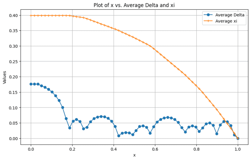

I’ve been working on solving gap equations related to superconductivity using Python, in the context of RMFT using the t-J model of the Hubbard Hamiltonian. My goal is to calculate and plot the variables (\Delta_x), (\Delta_y), (\xi_x), and (\xi_y) against the doping concentration (x). However, despite several attempts, I’m encountering errors in my code.

Specific Questions:
  1. Are there any mistakes in my loops or the reassignment of values?
  2. What could be causing the discrepancies between the expected graph and the actual graph I’m receiving?

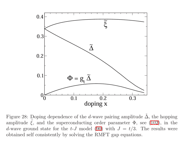

Expected Output: I expect a smooth plot showing how the superconducting gap evolves with increasing doping concentration.
Actual Output: The graph I’m currently getting doesn’t match my expectations.
I couldn't find any obvious errors, but I'm not familiar with the equations you are trying to solve. The best I can offer is to simplify it and look at solving at a single value of x and see if it is doing what it is supposed to. Is your iterative solution really converging? If it's really converged, you should be able to double the number of iterations and get the same results.

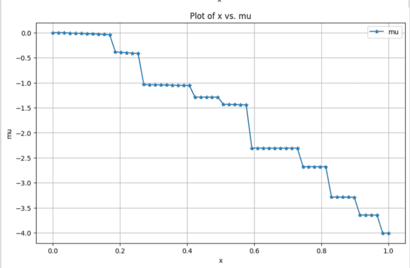

I tried solving for a single value of x but got the same result.
And, no, I don't think the iteration is converging, but I can't find a reason why. I think it has something to do with the \mu values, but after so many trials I still can't correct it.
I think this curve is supposed to be smooth, without the steps.
Make N_1 and N_2 bigger so you have smaller steps. 2X bigger to start. If the solution is different, you have not converged. Keep increasing them until it stops changing.
You're right, the steps do get smaller. However, at the same time, the value of \Delta at x=0 also gets smaller, which should not happen since its value should be near 0.35 at x = 0.
When N_1 and N_2 are 4x, \Delta is nearing 0.05.
Is there something else I can try?
Maybe I don't understand, but aren't you approximating a continuous function with discrete values of k? If so when you make the k step smaller, then the discrete steps should better approximate the continuous function, and it should approach the correct solution. If it doesn't, something is wrong. Instead of trying something else, keep digging into this one calculation until you find what is wrong.
I was supposed to use thee formulas:
g_t = 2 * x / (1 + x)
g_s = 4 / (1 + x)**2
After that the issue got resolved
