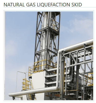

What kind of volume of gas do you need to produce with this installation? What is the application?
https://www.rtgastreat.com/natural-gas-liquefaction-skid-product/

So 5kg/s is 432 tons per day (TPD). This link shows a 280 TPD plant that was for sale. It doesn't say what it cost, but I suspect many millions of $
