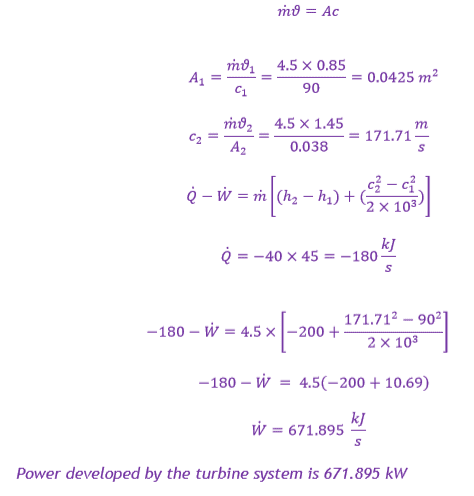

Handwritten-style worked calculation of turbine power using the steady flow energy equation: A1 = 4.5 x 0.85 / 90 = 0.0425 m2, c2 = 4.5 x 1.45 / 0.038 = 171.71 m/s, Q = -40 x 45 = -180 kJ/s, giving W = 671.895 kJ/s.
There is the worked solution they give you, do not understand it at all.
clark123 said:
Okay didn't realize that, would you be able to explain why please?
It's just the way they chose to do it. Nothing wrong with that.
Yes. They did a nice job. That was the answer I got.
If possible, would you be able to do some more detailed workings out with explanations as I cannot see where they have gone so quickly, take a photo and put it in here? No worries if not!
If I take your equation in post #4 and solve for ##\dot{W}##, I get:
$$\dot{W}=\dot{M}\left[\frac{\dot{Q}}{\dot{M}}-(h_{out}-h_{in})-\frac{(c_{out}^2-c_{in}^2)}{2}\right]$$
with $$\frac{\dot{Q}}{\dot{M}}=-40\ \frac{kJ}{kg}$$
$$(h_{out}-h_{in})=-200\ \frac{kJ}{kg}$$
and $$\frac{(c_{out}^2-c_{in}^2)}{2}=\frac{(171.71^2-90^2)}{2}=10692\ \left(\frac{m}{s}\right)^2=10692\ \frac{J}{kg}=10.692\ \frac{kJ}{kg}$$
