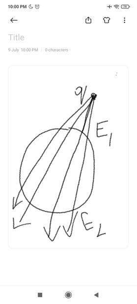

My teacher said that gauss law may not accounts for the field due to the outside charges in the LHS in this expression
##\int E.ds## = ##\frac{q}{\epsilon}## as field lines coming in the surface leave it as well. Hence the total flux is 0
However i dont think thats very consistent with the official definition of gauss law which states that the field due to both the inside and outside charges should be taken into account.
But his argument makes sense. Please explain why Its taken into account (if it is) and why not (if not)
One fallacy I found in his argument was the fact that equal number of field lines enter and leave the closed surface.. Isnt that wrong? If ive got an isolated point charge outside isnt the field changing with distance therefore at a distance x from the charge when its entering The closed surface its strength is different compared to a distance x+y where its leaving the closed surface..
Is my reasoning wrong?

Your reasoning is wrong.
Make a drawing showing a charge and some field lines from it.
Draw a region which does not enclose the chagre.
You will see that every field line entering the region also leaves it.
If you can devise a situation where this is not true, please post your diagram.

Im possibly misinterpreting something. This is the statement I was referring to. Its from HC verma class 12 concept of physics.
Also I drew a diagram like you said
I can see that field lines entering the sphere are equal to field lines leaving it.
I believe that in the ##\int E.da## expression the E1 and E2 difference is balanced out by the area somehow? Making the flux equal and opposite in magnitude?
(Sorry I know gauss law is considered easy but I have lots of gaps in my understanding )

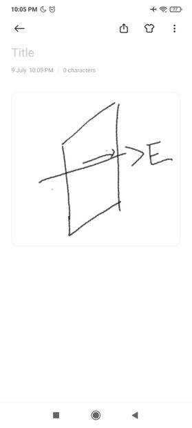

Also @Steve4Physics can you explain situations like these
This isnt even a closed surface yet ive seen gauss law questions like find the flux passing through this surface..

“Internal” (i) refers to the inside of some 3D region ##R##, bounded by the closed surface ##S##.
“External” (e), refers to outside ##R## and on the surface ##S##.
##\vec {dS}## is an oriented area-element.
##\vec E## is the total field . Electric fields obey the principle of linear superposition. That means at any point, the net electric field ##\vec E## is given by the sum of the fields from internal and external charges:
##\vec E = \vec {E_i} + \vec {E_e}##.
Consequently ##\int_S \vec E \cdot \vec {dS}## can be expressed as:
##\int_S \vec E \cdot \vec {dS} = \int_S \vec {E_i} \cdot \vec dS + \int_S \vec {E_e} \cdot \vec {dS}##.
As your drawing in Post #4 illustrates, ##\int_S \vec {E_e} \cdot \vec {dS} = 0##.
Does that resolve the problem for you?
I don't understand the diagram or question. If you are still unclear, maybe you can explain them.
The question is " What is the flux through a surface of dimensions x and y when kept in an external uniform electric field... But isnt flux related to closed surfaces?
Gauss's law is not relevant. You are being asked to caculate electric flux through a particular area, A, given the field. The area is not the surface of a 3D region.
The electric flux through the area is (by definition) give by ##\phi = \int_A \vec E \cdot \vec {dA}##. You don't use Gauss's law or even need the charge.
Edit - wording slightly changed.
