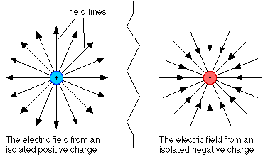

No. The law of superposition states that the electric field of a material is the sum of the electric fields of all the individual particles contributing to the electric field. That means that for both particles you can look at the electric field independently of the electric field of the other particle. Gauss' law holds for both particles independently and the electric flux of a volume will only depend on the charge of the particle inside the volume.
okay but then you must explain to me. Let's say we look at a +charge independently even though there is a -charge close to it. Then the flux through a closed surface is a measure of the amount of field lines passing through the closed surface, which by Gauss' law is only dependent on the charge inside the closed surface (right?).
But the minus charge will have field lines going through the surface and terminating on the plus charge. Why do these not contribute to the flux? Evidently they are indeed going through the closed surface.
Edit: Or is the E in the integral only supposed to be the E due to the charge we are confining?
The net flux is indeed only dependent on the charge inside a closed surface.
The net flux through a closed surface can be calculated for both particles independently (as of the law of superposition).

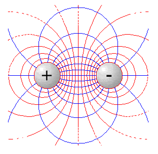

Now I'm not entirely sure what situation you try to picture but when you place two particles next to each other, there will not only be field lines between them, but in all directions around the particles. At the side of the particle opposite to the particle the field lines will reach the other particles at an infinite distance.
I found an image which might help illustrate it.
For any surface not enclosing either charge the integral [itex]\int_{A}\mathbf{E}\cdot\mathbf{n}dA[/itex] will be zero. This is easy to see for area's where [itex]\mathbf{E}[/itex] is uniform. Keep in mind that [itex]\mathbf{n}[/itex] is the outward unit normal vector.
So say we have the combined field of the two charges above and we want to calculate the total charge inside a sphere that confines the negative charge. The E in the flux integral in Gauss' law, does that then refer to the combined field of the two charges or just the field that the negative charge makes?
