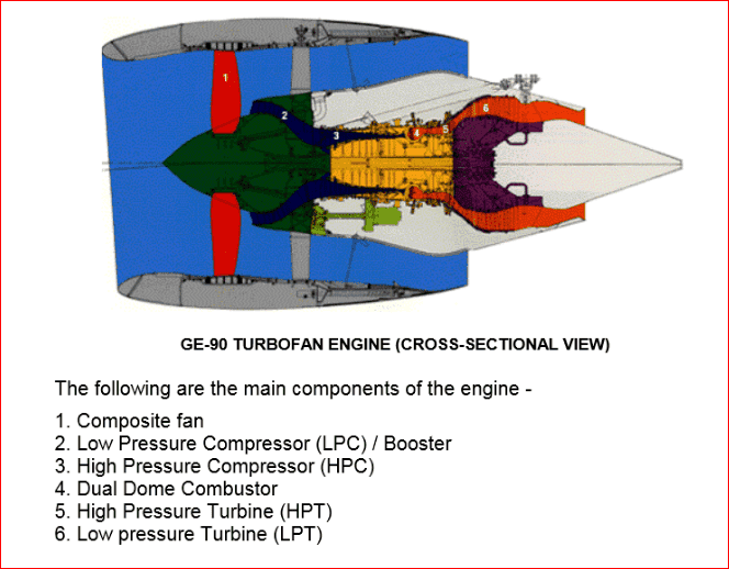

Train your search engine. It wants to please.
Lots more here, search on keywords
http://web.stanford.edu/~cantwell/AA283_Course_Material/GE90_Engine_Data.pdf
if you sent these folks a handwritten letter they'dprobably send you a sales brochure
http://www.geaviation.com/engines/
you do understand that modern engines (after Boeing 707) affix a shrouded propeller to the front of the engine. That's the big blades on right side of your picture.
The turbine engine makes so much shaft horsepower that it can move lots more air than is practical to move through its internal burners .
So most of it is directed around the engine itself, they call that Bypassing. You picked a high bypass engine.
Those big blades out front resemble a fan, hence the name "Turbofan". They're a lot more quiet than pure jets.
The internal losses from compressing and churning the air on its way through exceeds the power of a WW2 piston engine.Have fun reading.
