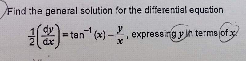

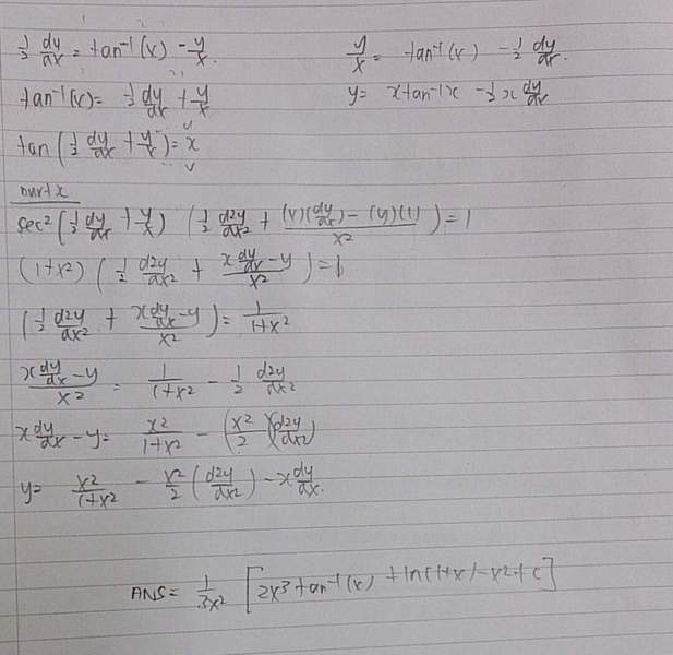

i got stucked here. below is the answer given. can anybody help please?

You can try to simplify the original equation by substituting y(x) = f(x).xn, then see what value of n will get rid of the -y/x term.
This looks like a straightforward "integrating factor" problem.

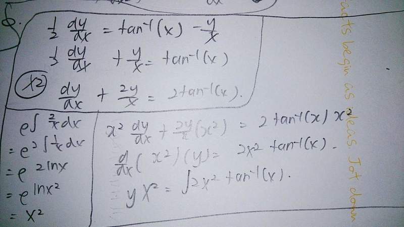

dy/dx +Py(x) = Q(X) if i rearrange i would get 0.5 dy/dx + y/x = arc tan x ... is arc tan x function of x?

Multiply both sides by 2. arc tan x is a function of x.

i redo the question and don't know how to proceed here... any idea on how should i do next ? i don't know how to integreate arc tan x

Integrate by parts. Do you remember how to take the derivative of arc tan x with respect to x?

sorry , i checked thru the syllabus, there's no deriative of arc tan x in it or maybe i can do it in other way? any other way?

Yes. Let y = arc tan x
Then tan y = x
Differentiating both sides with respect to x;
sec^2y\frac{dy}{dx}=1
Also, we have the trig identity: tan^2y+1=sec^2y
So, sec^2y=1+x^2
So, \frac{dy}{dx}=\frac{1}{1+x^2}
So, \frac{d(tan^{-1}x)}{dx}=\frac{1}{1+x^2}

thanks got the solution finally!
