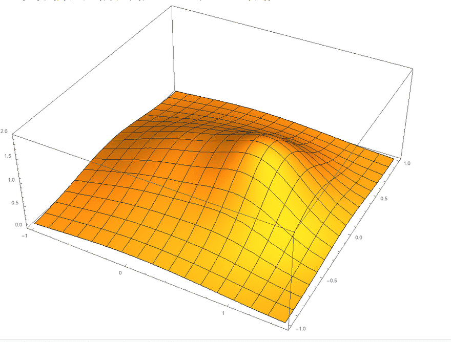

I would like to generate (X,Y) pairs such that they would follow a distribution something like this:
This is the sum of three normal distributions. Each distribution could have a different taper along the X and the Y, plus an offset along X and/or Y. So the parameters of these three distributions would be the input for my process.
I don't need to meet any rigorous test of randomness or compliance with the ideal model -- it just needs to look qualitatively like the model and be really EASY to understand and implement. Speed is not too much of an issue either.
What would be a simple algorithm?
that picture doesn't look like a 2-d normal --i.e. it isn't symmetric about the axis that goes from top left to bottom right. This rather obvious skew is a sign of (approximation?) problems looming.

maybe I misread this OP actually wants a mixture model. Frequently people here say adding distributions when they mean adding random variables, so hard to tell. The fact that the thread is titled 2-d composite binomial made me think we are actually dealing with adding normal random variables, not a mixture.
Suppose ##f_1, f_2,f_3## are probability density functions and you want to generate random samples from a probability density function ##g = k_1 f_1 + k_2 f_2 + k_3 f_3##, where the ##0 \leq k_i \leq 1_i## are constants. Since ##g## is a probability density, it must be that ##k_1 + k_2 + k_3 = 1##. So you can use ##k_1,k_2,k_3## as probabilities. To generate a random sample from ##g##, first pick which density ##f_i## to use. Pick ##f_i## with probability ##k_i##, Then generate a random sample ##(x,y)## from the density that was selected.
To deal with your example, we need to know how to generate random samples from a 2-D gaussian distribution. Do you know how to do that?

Stephen Tashi said:
To generate a random sample from gg, first pick which density fif_i to use. Pick fif_i with probability kik_i, Then generate a random sample (x,y)(x,y) from the density that was selected.
Thanks, that's pretty elegant. I wish I had thought of it :oops:. And it works the way sub-populations would actually contribute to the total stats according to their relative size.
