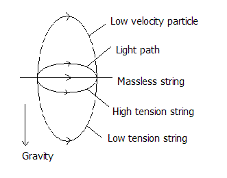

Here is another diagram. It shows the geodesics of a low velocity particle, a light ray, a low tension string with mass and a high tension string with mass compared to the path of a massless string. In a gravitational field none of the paths lie on the path of the massless string. Switch off the gravitational field and all the paths follow the path of the massless string.
I think I was pretty much "on the money" when I stated:
1) A particle with motion follows a path that minimises the time between two points.
2) An object with tension follows a path that minimises the distance between two points.
A particle with motion follows a path that tends towards a straight line as the velocity tends towards to infinity but it is limited by the speed of light, so it can never follow a straight horizontal path in a gravitational field.
An object with tension follows a path that tends towards a straight line as the tension tends towards infinity but presumably no real material can have infinite strength so this path is never truly a straight horizontal line in a gravitational field.
Only an object with no motion and no mass (a hypothetical massless string) can follow a true horizontal straight line in a gravitational field.
In the absense of readily available massless string in the hardware stores, if you want to build a perfectly straight garden wall you will have to take the average of the builders chalk line and laser leveling device.
  • Diagram of a horizontal straight line labelled Massless string, with a downward arrow labelled Gravity; an ellipse-like curve labelled Light path and dashed curves labelled Low velocity particle, High tension string and Low tension string bend below the line, with arrows showing direction of travel.
