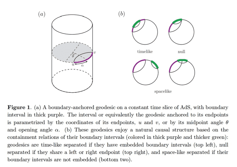

I need to find the geodesics of AdS3 spacetime. But my searches have given me nothing. Can anyone give a reference where they're calculated?
Thanks
Can't tell if this is what is needed,
From, https://arxiv.org/pdf/1604.02687v2.pdf
Which is from, https://inspirehep.net/record/1445018/plots
Which is from, https://www.google.com/search?q=geo...tvvRAhXF5oMKHZVQDBQQ_AUICCgB&biw=1024&bih=490
Interesting, but not what I needed. Thanks anyway.
P.S.
I can try to find a parametrization for curves in those pictures but I need a rigorous derivation of the geodesics.
