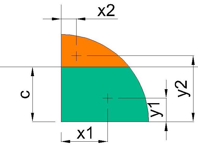

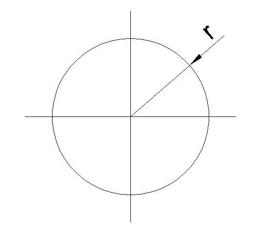

I am after finding general geometric expressions for a quarter-circle that is split into two segments along either its domain or range (they are equal). I.e. Taking the circle shown in Figure 1 and concentrating on the upper right quadrant, I am after expressions for the individual areas (top and bottom) and their respective centroids x1, y1 and x2, y2 (Figure 2) when cut at "c".
Figure 1:
Figure 2:
Area of circle = ∏r^{2}
Equation of quarter circle: y(x) = √(x^{2}-r^{2})

If you immagine the other half of the circle you can use the equation:
\bar{y}=\frac{4Rsin^{3}(\frac{1}{2}θ[STRIKE][/STRIKE])}{3(θ-sin(θ))}
where θ is the theoretical angle to create the chord to get your y bar for the top section. Then you can calculate the y bar for the whole quadrant by using the equation:
\bar{y}=\frac{4R}{3π}
Since the average of the top and bottom y bar have to equal the quadrant based on their area you can take the weighted average of the top area and the y bar with the weighted average of the bottom area equaling the total area and the total y bar. From that you can get your y bars and then you can do the same thing for the x bars. Might sound confusing so if you don't understand let me know, I'll try my best.
Area of top part:
A=\frac{R^{2}}{2}(θ-sin(θ))
