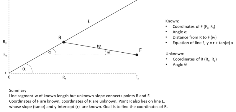

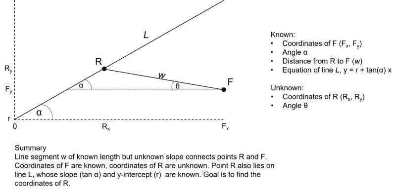

The image below should explain the problem and the constraints. Basically, I know the location of one point (F) in 2-D space (Cartesian coordinates). A line segment (w) of known length connects this point to another point (R). The coordinates of R are unknown; however, it is known to lie on a line (L), the slope and y-intercept of which are known (tanα and r). My intuition is that this should be solvable and not all that complicated. The slope of segment w is unknown, but there should only be one angle that allows a segment of that length to exactly reach line L. But I cannot figure it out so I am appealing to the community.
The equation of the line is ##y = \tan(\alpha)x + y_0##, where ##y_0## is the known y-intercept. A circle of radius w is ##(x - F_x)^2 + (y - F_y)^2 = w^2## will intersect the line at two points, one of which is the point you seek. One of these line segments will have a slope that is an acute angle, and the other will have an angle that is greater than 90°.

Of course, thanks. I like the idea of thinking of a circle with radius w with origin at point F that includes point R. In fact, the physical meaning of this problem came from realizing that, if you do it backwards and start with known R, there is a circle of radius w comprising possible points (including F) determined by the angle of the connecting segment w. So I should have thought of that.
So now, as I see it, I have two equations for two unknowns. The circle equation has two unknowns, Rx and Ry, but the equation of line L gives me Ry as a function of Rx, so I can substitute. So I have:
w2 = (Rx - Fx)2 + (y0 + tanαRx - Fy)2

Given alpha, you can make a right triangle, which gives you theta. Since you know the hypotenuse length, you should be able to calculate all parameters of the triangle.

Oh silly me... It looks like your problem only specifies one side length and the opposite angle. I'd be interested to see if this is solvable with the other info provided. I got thrown off a bit by the diagram showing the bottom as horizontal.
steveZ said:
I wish that were so, but if you look at the diagram again, I think you will see that it is not so easy.
What I'm seeing, one could imagine moving the corner of the triangle to the origin, and reducing the problem to solving a triangle with only one known side length and one known angle (which is not solvable). The offset along R seems irrelevant in the grand scheme of things.
Ok, it makes sense now... You can move the point R pretty much anywhere along the line L and still keep length w constant because theta is unspecified. There is no unique solution to this problem.

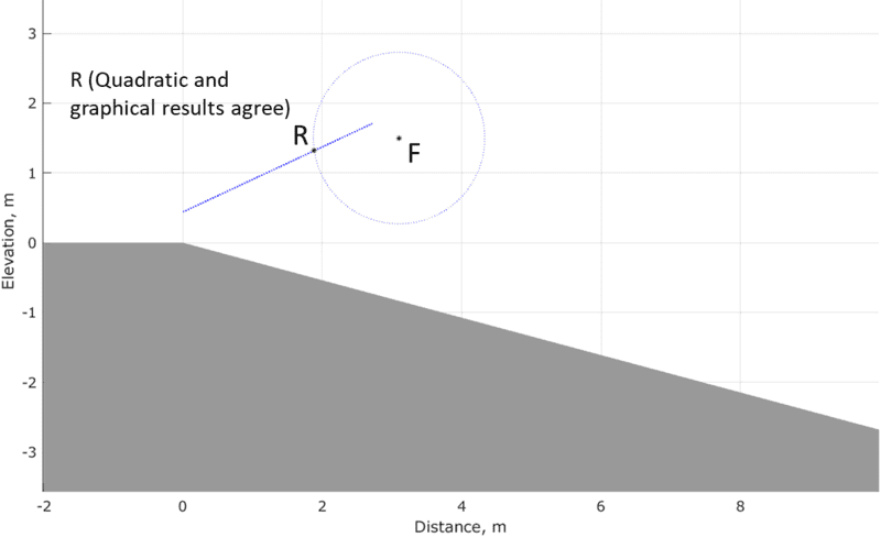

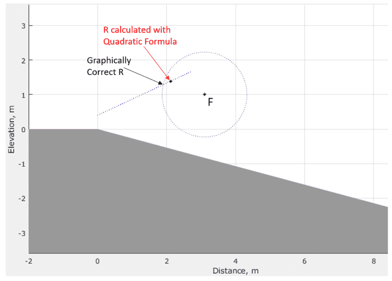

steveZ said:
I have written code to plot my results and also the circle and line whose intersection we are trying to find. You can see in the image below that there is a small error that I am trying to nail down.
That error looks pretty significant to me, maybe .3 meter or so. I haven't done the calculations, but I would guess that the incorrect results stem from calculation errors.

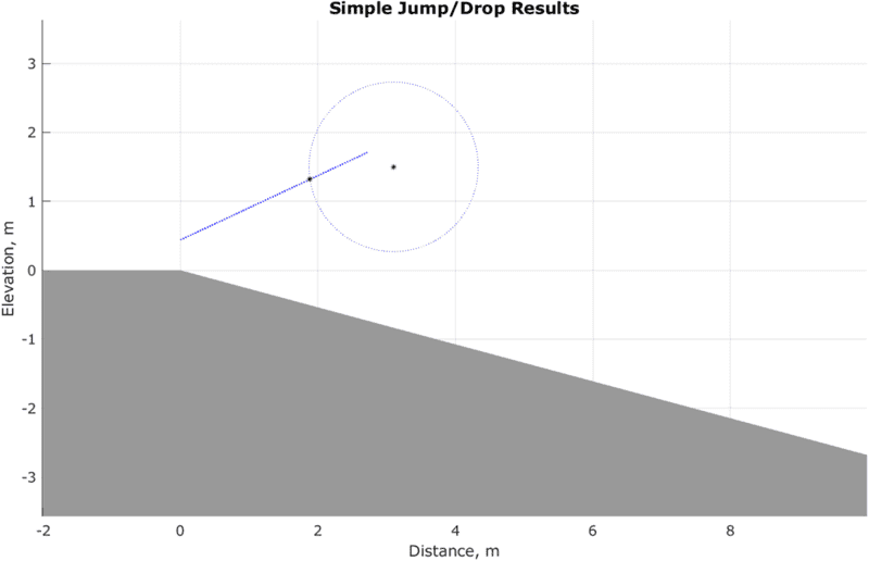

It was a mistake I made when doing the algebra. A factor of two on one of the terms that went into the quadratic. I caught it on my third try solving for R. Here is the latest result, which seems correct. Thanks again for your help.
