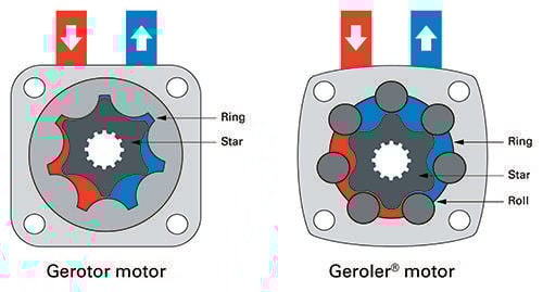

Hi. I want to design a custom Geroler motor for a hobby project of mine, but I want to calculate the torque it can produce at a given pressure and for that i need to calculate the motors displacement, but how do i do that?

To find the torque, you must look at the areas that oppose the input and output pressures. You must also look at the radius to those areas. For a geroler, those areas are the sides of the gear teeth multiplied by the axial length of the gear. The radius of the geroler crank is important in computing torque.

I can't think of a more difficult motor to make. You will need a set of valves machined into the shaft to direct the fluid. You will need a diagonal shaft with modified splines at both ends, or a crank.
If one gear rotates against another rotating gear it is a gear motor, or a gerotor.
If one gear rotates inside a fixed gear it is some type of vane motor, or a geroler.
It would be easier to make a traditional two-gear motor, or a gerotor with a rotating spool to carry the rollers, with an inner rotor profiled like the rotor in a geroler. Those ways your inlet and exhaust ports can remain fixed.

Geroler is not a technical term, it is a Trade mark. You will need to ask the holder how they define a geroler.
Will the centre of the rotor in your motor be fixed, or will it orbit the shaft?
That has implications to the valves you will use to direct the fluid.

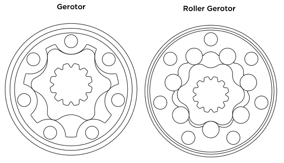

I was thinking the housing with the rollers would rotate together with the "star" yes. So i can have a simple fixed valveplate.
If you look at the roller-gerotor diagram in my post #7, you will see that there is a maximum fluid volume between two rollers when two rotor lobes touch those two rollers. That area is at the top of the rotor.
You will also see that there is a minimum fluid volume at the bottom of the rotor where a rotor lobe is between two rollers.
For a 6 lobe rotor, the displacement per shaft revolution is 6 times the difference between those volumes.
