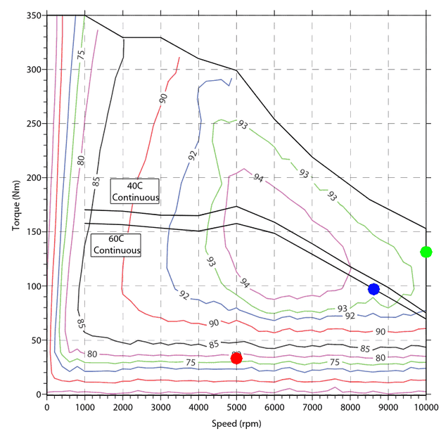

Hi I am trying to do an artisanal EV car and I would like to know how do I choose the right motor. I already have one in mind but I don't know how to calculate the max mass that it can move. (see attached pdf)
Gear Ratio : 2.39
Diff Ratio : 4.88
Wheel Diameter: 26in
I would like to know the formula to calculate the car max weight from motor torque
The car would be RWD

as for max speed I would be ok with 2.39 and 4.88 gear ratio I should be able to go 80kmh @ 7.5krpm and 106kmh @ 10krpm but this gear arrangement is to maximize towing capacity because this would be "low gear" and "high gear" would be 1.11 and 4.88 and would be for highway and everyday use and should be able 115kmh @ 5krpm and 230kmh @ 10krpm this should give me better battery consumption

The typical amount of power you need for highway (mostly due to aerodynamic drag) is about 25 hp. At 5000 rpm, this means 26 lb.ft (or 35 N.m) of motor torque. According to the efficiency map of your pdf file, this is where you are:
(red dot: 115 km/h; blue dot: 200 km/h; green dot: 230 km/h)
As you can see, with this motor, your vehicle would be most efficient at cruise speeds of around 200 km/h, which is also the maximum speed that you can use continuously.

Redoing the previous exercises with a new gear ratio, note that if you could use a higher gear ratio instead of 1.11:1 you would maybe end up in a more favorable zone of your motor where you would gain efficiency at lower speeds while losing nothing at high speeds. You even gain a higher top speed (torque-limited instead of rpm-limited), with only a minor loss in the maximum cruise speed (I imagine you don't need to drive over 185 km/h continuously anyway?). The results are In the following table (some are eyeballed):
