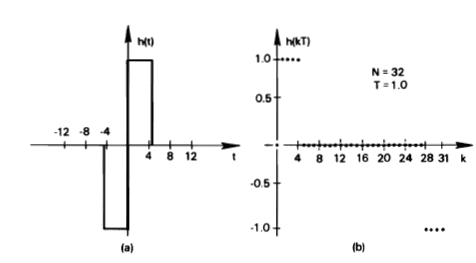

See attached picture.
When taking the DFT, why do we have to take the time waveform to be (b) rather than (a)?

just want to match the DFT result to FT which should be scaling by T (see wiki link I posted).
Your wiki link says that DFT = (1/T)*FT. You want DFT to look like FT, so you solve for FT:
FT = T*DFT
For a discrete n sec. signal, the sampling rate T is inversely proportional to the N, the number of samples. (n = T*N)
so T ~ 1/N
