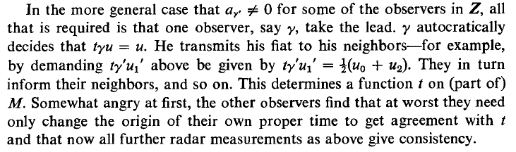

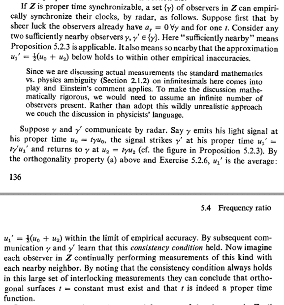

You mean take the timelike geodesic worldline of Earth's center (it is geodesic since the center is in free-fall) and a set of massive objects whose timelike worldlines do not intersect (a congruence), do not rotate (i.e. hypersurface orthogonal) and are at rest w.r.t. the Earth's center worldline (as measured by constant travel time of bouncing light beams exchanged between Earth's center worldline and each of the congruence's worldlines).
What does physically mean the above conditions to be non-rotating/irrotational ? From Sachs and Wu section 5.3 geodesic and irrotational conditions are equivalent (iff) to locally proper synchronizable.
Then two observers in the congruence, communicating via radar (bouncing light beams), can check the above consistency condition that is basically the Einstein's clock synchronization convention.
Reading again Sachs & Wu section 2.3 I believe the difference between locally synchronizable vs synchronizable is about the domain of definition of ##C^{\infty}## functions ##h## and ##t## such that the differential 1-form ##\omega## (that defines the 3D spacelike distribution orthogonal to the congruence's timelike worldlines at each point) is written as ##\omega = - hdt##.
In the latter both functions are globally defined on spacetime manifold, while in the former only locally (in an open neighborhood of each point).
Physically it means there are no "fictitious forces" in the frame, in the Newtonian sense, i.e., no centrifugal or Coriolis force. In the absence of gravity we would say that meant the worldlines of free-falling objects are straight lines in the frame, but since gravity is present (due to the Earth), we can't say that. So the ECI frame is really only "inertial" in the Newtonian sense (where gravity is not considered a "fictitious force" and it's OK for the worldlines of objects free-falling under gravity to not be straight lines in the frame). It is not "inertial" in the GR sense (and in the GR sense it is impossible to define a single inertial frame that covers the entire Earth and its neighborhood, as the ECI frame does).
The geodesic condition is not met since only one worldline at rest in the frame (that of the Earth's center) is a geodesic. The congruence that defines the ECI frame is, in Sachs and Wu terminology, locally synchronizable (a common set of simultaneity surfaces can be defined that are everywhere orthogonal to the congruence) but not locally proper time synchronizable (gravitational time dilation is present).
