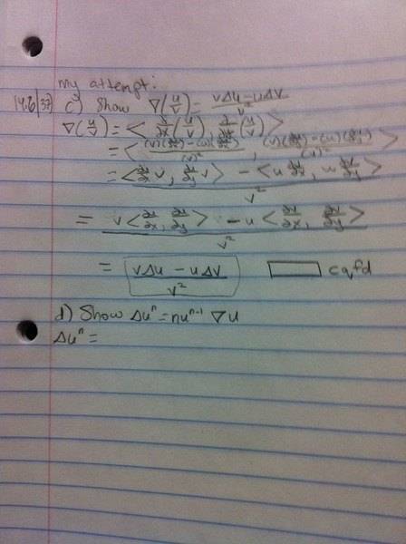

Show that the operation of taking the gradient of a function has the given property. Assume that u and v are differentiable functions of x and y and that a, b are constants.
Δ = gradient vector
1) Δ(u/v) = vΔu - uΔv / v^2
2) Δu^n = nu^(n-1)Δu
I tried taking the partial derivative of (u/v) and separating the terms but I didn't get the ending result.
For 2, I don't even know where to begin because it is an exponent.

Let's try a simpler problem:
[tex]\nabla(uv) = v\nabla{u} + u\nabla{v}[/tex]
[tex]\nabla(uv) = <\frac{\partial (uv)}{\partial x}, \frac{\partial (uv)}{\partial y}>[/tex]
[tex]= <u\frac{\partial v}{\partial x} + v\frac{\partial u}{\partial x}, u\frac{\partial v}{\partial y} + v\frac{\partial u}{\partial y}>[/tex]
[tex]= u< \frac{\partial v}{\partial x}, \frac{\partial v}{\partial y}> + v< \frac{\partial u}{\partial x}, \frac{\partial u}{\partial y} > = u\nabla{v} + v\nabla{u}[/tex]
I was given that problem for homework as well and I was able to do that one. I have an idea on how to do the quotient rule one, but no idea for the second question.
If (2) is to be done for n a positive integer, use induction on n.
This is my attempt at the quotient rule proof. Did I do the correct thing for this problem at least? I'm still unsure how to do the second question...
Yes, that looks fine although the second line is difficult to read.
For the other problem, use induction (the tacit assumption is that n is a positive integer). The base case is easy to establish.
[tex]\nabla u^1 = \nabla u = 1 \nabla u[/tex]
Now assume that for n = k,
[tex]\nabla u^k = k \nabla u^{k - 1}[/tex]
To complete the proof, show that for n = k + 1
[tex]\nabla u^{k + 1} = (k + 1) \nabla u^k[/tex]
