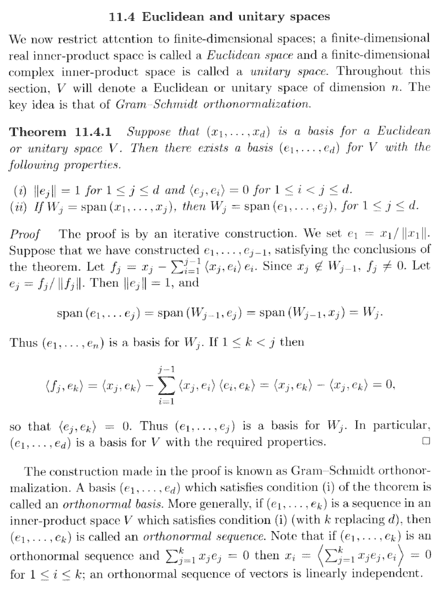

I am reading D. J. H. Garling's book: "A Course in Mathematical Analysis: Volume II: Metric and Topological Spaces, Functions of a Vector Variable" ... ...
I am focused on Chapter 11: Metric Spaces and Normed Spaces ... ...
I need some help with an aspect of the proof of Theorem 11.4.1 ...
Garling's statement and proof of Theorem 11.4.1 reads as follows:
In the above proof by Garling we read the following:
" ... ... Let ##f_j = x_j - \sum_{ i = 1 }^{ j-1 } \langle x_j , e_i \rangle e_i##. Since ##x_j \notin W_{ j-1 }, f_j \neq 0##.
Let ##e_j = \frac{ f_j }{ \| f_j \| }## . Then ##\| e_j \| = 1## and
##\text{ span } ( e_1, \ ... \ ... \ e_j ) = \text{ span } ( W_{ j - 1 } , e_j ) = \text{ span }( W_{ j - 1 } , x_j ) = W_j##
Can someone please demonstrate rigorously how/why##f_j = x_j - \sum_{ i = 1 }^{ j-1 } \langle x_j , e_i \rangle e_i##
and
##e_j = \frac{ f_j }{ \| f_j \| }##imply that##\text{ span } ( e_1, \ ... \ ... \ e_j ) = \text{ span } ( W_{ j - 1 } , e_j ) = \text{ span }( W_{ j - 1 } , x_j ) = W_j##
Help will be much appreciated ...
Peter

Reflecting on my post above I have formulated the following proof of Garling's statement ... ...##\text{ span } ( e_1, \ ... \ ... \ e_j ) = \text{ span } ( W_{ j - 1 } , e_j ) = \text{ span }( W_{ j - 1 } , x_j ) = W_j##
We have ##e_1 = \frac{ f_1 }{ \| f_1 \| } ## and we suppose that we have constructed ##e_1, \ ... \ ... \ e_{j - 1 }## , satisfying the conclusions of the theorem ...Let ##f_j = x_j - \sum_{ i = 1 }^{ j-1 } \langle x_j , e_i \rangle e_i##Then ##e_j = \frac{ f_j }{ \| f_j \| } = \frac{ x_j - \sum_{ i = 1 }^{ j-1 } \langle x_j , e_i \rangle e_i }{ \| x_j - \sum_{ i = 1 }^{ j-1 } \langle x_j , e_i \rangle e_i \| }##
So ...
##e_j = \frac{ x_j - \langle x_j , e_1 \rangle e_1 - \langle x_j , e_2 \rangle e_2 - \ ... \ ... \ ... \ - \langle x_j , e_{ j - 1 } \rangle e_{ j - 1 } }{ \| x_j - \sum_{ i = 1 }^{ j-1 } \langle x_j , e_i \rangle e_i \| }##Therefore ...
##x_j = \| x_j - \sum_{ i = 1 }^{ j-1 } \langle x_j , e_i \rangle e_i \| e_j + \langle x_j , e_1 \rangle e_1 + \langle x_j , e_2 \rangle e_2 + \ ... \ ... \ ... \ + \langle x_j , e_{ j - 1 } \rangle e_{ j - 1 }##Therefore ##x_j \in \text{ span } ( e_1, e_2, \ ... \ ... \ , e_j )## ... ... ... ... ... (1)
But ##W_{j-1} = \text{ span } ( x_1, x_2, \ ... \ ... \ , x_{ j - 1 } ) = \text{ span } ( e_1, e_2, \ ... \ ... \ , e_{ j - 1} )## ... ... ... ... ... (2)Now (1) (2) ##\Longrightarrow \text{ span } ( x_1, x_2, \ ... \ ... \ , x_j ) \subseteq \text{ span } ( e_1, e_2, \ ... \ ... \ , e_j )##But ... both lists are linearly independent (x's by hypothesis and the e's by orthonormality ...)
Thus both lists have dimension j and hence they must be equal ...That is ##\text{ span } ( x_1, x_2, \ ... \ ... \ , x_j ) = \text{ span } ( e_1, e_2, \ ... \ ... \ , e_j )##
Is that correct ...?
Can someone please critique the above proof pointing out errors and/or shortcomings ...Peter
*** EDIT ***
Above I claimed that the the list of vectors ##e_1, e_2, \ ... \ ... \ , e_j## was orthonormal ... and hence linearly independent ... but I needed to show that the list ##e_1, e_2, \ ... \ ... \ , e_j## was orthonormal ...To show this let ##1 \le k \lt j ## and calculate ##\langle e_j, e_k \rangle## ... indeed it readily turns out that ##\langle e_j, e_k \rangle = 0## for all ##k## such that ##1 \le k \lt j ## and so the list of vectors ##e_1, e_2, \ ... \ ... \ , e_j## is orthonormal ...Peter
You just have to note that ##f_j## is orthogonal to ##e_{j-1}, ... ,e_0##.
