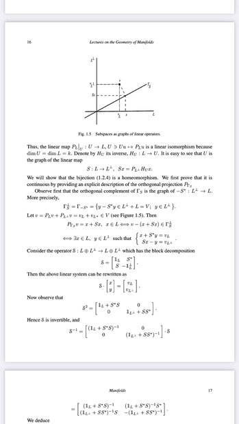

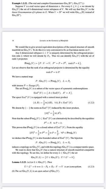

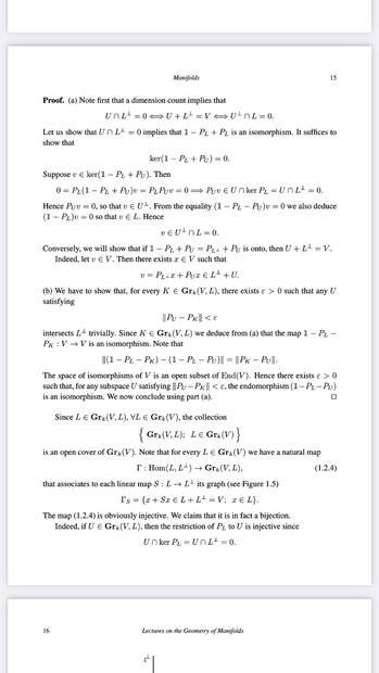

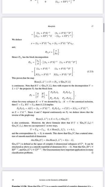

There is a proof that Grassmannian is indeed a smooth manifold provided in Nicolaescu textbook on differential geometry. Screenshots are below
There are some troubles with signs in the formulas please ignore them they are not relevant. My questions are the following:
1. After (1.2.5) there is a matrix block form decomposition for projector and the line that puzzles me
"where for every subspace ##K\rightarrow V## we denote ##I_K :K\rightarrow V## the canonical inclusion, then ##U=\Gamma_S##. This last "then ##U=\Gamma_S##" causes troubles since it was already shown that subspaces can be identified with images of homomorphism. Why author put it here?
2. To show that bijection between projector and homomorphism is continuous some sort of metric in the space of homomorphism is required to induce topology. How topology on there homomorphism is built? (Perhaps here I am asking something every undergraduate students knows. Sorry for that)
3. Proof ends on showing that corresponding subspaces are isomorphic with homomorphism but in manifold theory I need a map to ##R^n## or ##C^n##. How one approaches the latter?
Many thanks in advance

This is a messy proof and I would have to spend more time to look at it more precisely to answer your specific questions. I am more familiar with Lee's proof in his book Introduction to Smooth Manifolds which you can find in example 1.36 here.
The basic idea is that by choosing basis for ##L## and ##L_{\perp}##, ##\hom(L,L_{\perp})## can be thought of an ##M(n-k,k)## matrix which is essentially ##\mathbb{R}^{k(n-k)}##. ##\Gamma_S## is a map from ##\hom(L,L_{\perp}) \rightarrow Gr_k(V, L)##. Hence, ##\Gamma^{-1}_S: Gr_k(V, L) \rightarrow \hom(L,L_{\perp})## or with the identification mentioned above by choosing a basis, ##\Gamma^{-1}_S: Gr_k(V, L) \rightarrow M(n-k,k) \cong \mathbb{R}^{k(n-k)}##, which can serve as a chart for the open set ##Gr_k(V, L)## .

I am very thankful to everyone for clarifying the subject to me. Proof in the Lee's book is indeed consistent and there are no questions left
