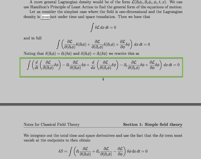

hi, I was looking some equations related to invariance of lagrangian. In my attachment you can see that there are 4 equations, and while the we proceed to 4. equations from 3. equations (green box) you can see that first term and third term of 3. equation vanishes. I would like to ask how these terms vanish mathematically. Could you explain this situation using some mathematical demonstrations?
they are total derivatives within the integral, they will vanish eventually...
Initially, thanks for your return, but I can not get the logic well So I am asking to visualize the concept in order to comprehend well : Could you explain in more detail using some mathematical stuff?
You use Stoke's theorem to convert these integrals into surface integrals. Upon using boundary conditions (variations at the boundary vanish), these terms will vanish.
I can not prove it to myself by hand using your answers, Would you mind helping me a little bit more ?
By the way ChrisVer you said that total derivatives within the integral, they would vanish eventually. Is there a proof of it ?
I mean at the end of the day, in every variation formalism you go to, you will eventually get some EOM that will have:
[itex]S = \int L(x ,\dot{x} ;t ) dt[/itex]
Correct?
then the concept is that the Lagrangian is not uniquely defined, but there is a whole set of Lagrangians that could in general produce the same equations of motions. Those lagrangians in the above case are:
[itex]L + \frac{d}{dt} K[/itex]
with the last term being a total derivative... The total derivatives don't survive into the equations of motion after the Lagrangian variation. The [itex]dK/dt[/itex] will by default satisfy the Euler-Lagrange equation.
Another way to see that is by looking at the integrals you have; they will eventually give you 'surface' terms, which in general can lead to some "constraints" over your fields... where? at infinity...
What is this integral equal to:
[itex]\int_{a}^{b} \frac{dA(x)}{dx} dx = ?[/itex]
[itex]A(x)[/itex] is a parametrized line, but the result of this int is 1 number... the generalization to more dimension's why these type of things are called 'surface' terms...
Another example from the 'classical case' of a relativistic string is that those "surface" constraints will generally result to the known "boundary" conditions for the oscillating string (like Neumann or Dirichlet ones).
Sorry I have to correct something: the 'classical case' is of a string in general (even non-relativistic)... I specified "relativistic" because I happened to read the application in relativistic strings in the past...
