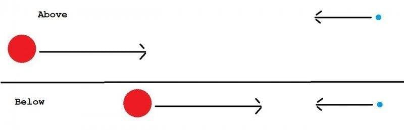

Okay, since we are in the heat of it, although this might be off topic. I'd like to ask anyway.
At the picture above,
1: Is there a chance that Red and Blue will collide?
2: Red and Blue must collide?
3: Is there a chance that Red and Blue will revolve each other?
4: Red and Blue must revolve?
Below
5: Is there a chance that Red and Blue will collide?
6: Red and Blue must collide?
7: Is there a chance that Red and Blue will revolve each other?
8: Red and Blue must revolve?
Thanks for any answer.
Add: Below
Red and Blue in a straight line
Below
Add: Below
What do you think? You've been studying physics for long enough now. What do you have to show for it? :smile:
I think at the picture above, could have missed, could have hit.
But...
PeroK said:
I'm baffled by this post. We wouldn't revolve around the big object: it would smash into us, surely?
But...
Draw a diagram to scale of two billiard balls in space on a near collision course; and the same diagram to scale of two planets on a near collision course. Let's assume the billiard balls miss each other. Will the planets miss each other? Or, with gravity does size matter?
In other words, you didn't give nearly enough information to figure out what will actually happen. But in both cases, it looks like you don't intend for the incoming small object Blue to already be in orbit about the large object Red. If that's the case, then no amount of free-fall motion will put Blue into orbit about Red; it will either hit Red, or fly past and escape. That is what previous posters have been trying to tell you.
