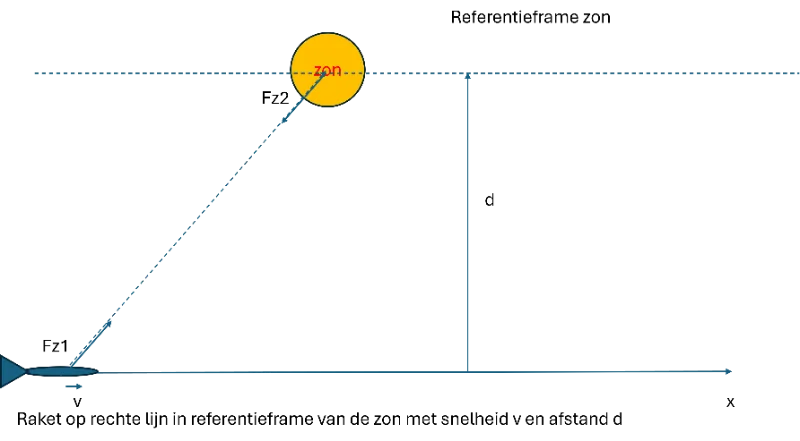

We also had this discussion at the dutch forum and there I took the next thought experiment; hope that helps to further get clearification.
The sun in its frame of reference and a fast moving rocket with speed v in a straight line along the x axis at distance d from the sun.

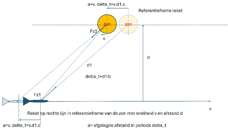

the next picture is the situation seen from the rocket frame of reference. from the rocket you see the sun moving toe the left with speed -v
now the question is: what happens with a mass in the rocket at the moment that I let it float, basically allowing it to follow a geodesic. (the rocket goes in a straight line so is forced not to follow a geodesic)
now the question is what is the direction of free falling mass in the rocket? is this according to fz1 pointing to the position of the sun (faint drawing) where it was at the moment it sent out the information of gravity that is received now in the rocket or pointing to some different direction?
It is a different direction. It is the direction from the location I described above.
Basically you start at the retarded position and extrapolate where the source will wind up by moving at the retarded velocity until the current time.
So if we talk about constant speed then if I understand you right it is the currernt position of the sun at the moment that the information of the gravity reaches the rocket? so basically what you would also expect with Newton.
Yes
But if so, is then my conclusion right that spacetime curvature takes care of this effect basically extrapolating for the speed (as I could predict the current position of an object of say 10 lightminutes away, so initially sounds as not causal as I measure gravity at a different direction (in the future) then where the light seems to comes from.)
In the weak field approximation the Einstein field equations take the same form as Maxwell's equations, and you can view the field as providing a "gravitoelectric" and "gravitomagnetic" force that behave the same as the EM forces. The gravitoelectric force points at the retarded position of the Sun (as you guessed), but when you add the gravitomagnetic force you get a resultant that points at where the Sun is now. So orbits are stable.
It remains causal. The force points at where the Sun is now assuming the Sun is in freefall. If I were to accelerate the Sun with a sufficiently powerful rocket, the Earth would continue in its current orbit for eight minutes.
