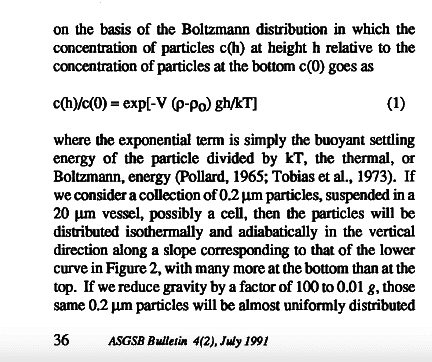

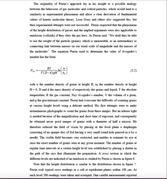

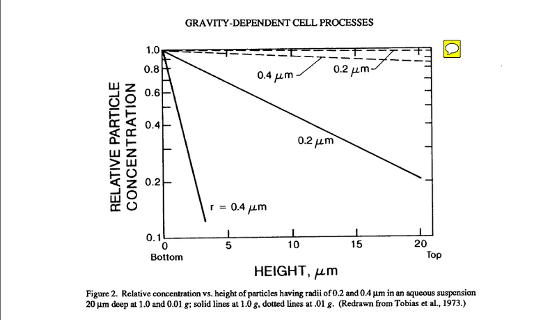

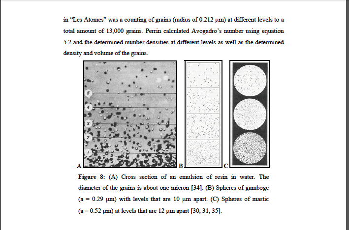

I've attached screenshots showing this isothermal/barometric distribution does occur. However, I think given the particles in their example were a lot larger than 5nm proteins (and usually in these experiments these are insoluble particles) that this distribution would be much smaller with a small (5nm) water soluble protein.
Perhaps this distribution does exist in cells (more towards the bottom than the top) but maybe it's to a very small degree, due to smaller diameter solute size of proteins/DNA and the fact that these are water-soluble. So being in a water solvent should give these particles more kinetic energy (and thus less sedimenting/distribution).
It's all still very confusing to me. We just calculated that the difference in gravitation potential energy should be negligible. Why then are these small particles in this example that I attached showing a distribution in location with more towards the bottom of a small container/cell?

According to your file 1*, Brownian motion counterbalances sedimentation for particles < 0.5 µm in diameter. Remember that volume (and hence mass) scales with length^3, so these particles, which are 100 times larger than 5 nm proteins, will be 100^3 = 1,000,000 times as massive (which, not coincidentally, gets you to the mass range where gravitational potential energies are comparable to kBT, as you calculated above).

I understand now. So, on the graph in file 3* - If we had a particle with a radius the size of a protein (like 2.5nm... or even 25nm like for a virus) that would be just about 1.0 for concentration at top vs bottom, correct?
What about file 3 (look at figure 8, letter B) there it says a = 0.29 um - these are showing a clear asymmetry in distribution with more towards the bottom ... not sure whether this is radius (in which case would be fine because that would be 580 nm diameter which is huge), but if it's talking about diameter, then that's starting to get pretty small (290nm) and that would contradict our reasoning.

Even if it's a 0.29 µm diameter, that's still ~200,000 times more massive than a typical protein.
