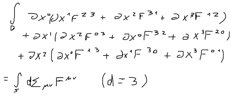

Thanks @vanhees71. I have two questions:
1 - What does ##d \Sigma_{\mu_{d+1}... \mu_{4}}## mean? And what name can we give to it?
2 - Why the indices of your tensor ##F## stops at 4 (i.e. ##\mu_4##)?
I don't understand, because I have written explicitaly all the components of the right hand side and it seems that the integrand vanishes, since ##F^{\mu \nu} = -F^{\nu \mu}##. (OOPS, I'm sorry, I did it for the case ##d = 2##, not 3 as said in the image below. Every other thing is for d = 2, though.)
##d \Sigma_{\mu_{d+1}... \mu_{4}}## is the hypersurface element. It's analogous to the surface-normal vectors in 3D vector calculus: There it's a vector perpendicular to the surface with the length given by the area of the surface element it belongs to.
The indices stop at ##\mu_4## because spacetime is four-dimensional. You can thus have only 1D (curves), 2D, 3D hypersurfaces and 4D volumes.
