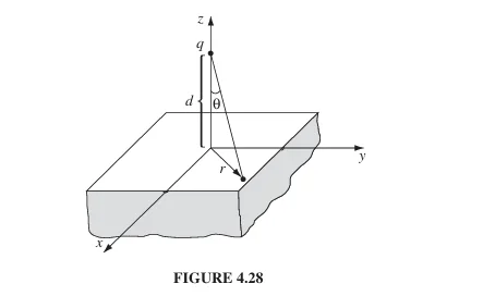

I am reading the Griffith, Electrodynamics book, 4th edition, Example 4.8 and stuck at some statements. It's little bit confused.
> Example 4.8. Suppose the entire region below the plane ##z=0## in Fig. 4.28 is filled with uniform linear dielectric material of susceptibility ##\chi_e##. Calculate the force on a point charge ##q## situated a distance ##d## above the origin.

( Cont. ) From Coulomb's law, the former contribution is
$$ -\frac{1}{4 \pi \epsilon_0}\frac{q}{(r^2 + d^2)} \cos \theta = -\frac{1}{4 \pi \epsilon_0}\frac{qd}{(r^2+d^2)^{3/2}}$$
, where ##r= \sqrt{x^2+y^2}## is the distance from the origin.
Q.3. Why the former contribution is given by such that? Why the cosine term is appeared?

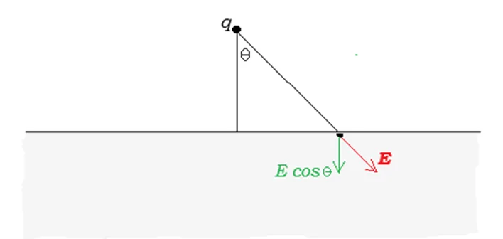

A.2 This field is due in part to ##q## and in part to the bound charge itself.
Look at the drawing. The net field inside is the vector sum of the external field and the field generated by the polarized atoms.
A.3. Why the former contribution is given by such that? Why the cosine term is appeared?
It is the vertical component of the electric field exerted by a dielectric surface element on the charge. That is why the cosine. The horizontal component of the Coulomb force is cancelled by the symmetrically-located surface element on the other side. The net horizontal force on the charge is zero by symmetry.

Griffiths is considering the z-component of the electric field due to the point charge ##q## at a point just inside the dielectric:
The factor of ##\cos \theta## comes from finding the z-component of the electric field ##\mathbf E##.
