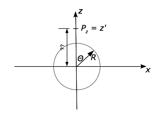

I tried to express the problem by a drawing. Does this make sense?
Here, $$P_z$$ is the z-component of the point $$P,$$ for which the dipole moment is evaluated, and it has arbitrarily a value of $$z'.$$ My problem is, that I can't see how $$(R \cos \theta)$$ translates to the distance marked as $$??.$$

I think you need to go back to your textbook and look up how Griffiths defines \mathbf{r}'. The dipole moment is independent of where you measure it from (the field point), and this should be obvious to you when looking at equation 3.98, provided you understand what the primes on the variables means, and what you are really integrating over.

I know the primed variables indicate the source point, the unprimed variables the field point. This infact is the solution to my problem!
Now I realize that in Eq. 3.98 a primed r is used, so what (R \cos \theta) means is the z-coordinate of the source point on the spherical shell.

Right, but just be careful here. The "primes" are unnecessary (the primed coordinates all get integrated over, so they are essentially just dummy variables in the same way that \int_a^b f(x)dx = \int_a^b f(u)du ) and many authors will leave them out. The fact that you integrate only over the source (since the charge density is zero elsewhere!) is what really tells you that the \mathbf{r}' in equation 3.98 is the location of each bit of source charge (it is the same as the argument of the charge distribution \sigma(\mathbf{r}')).
Equation 3.98 could just as readily be written as \mathbf{p} =\int \mathbf{r} \sigma(\mathbf{r}) da and still be valid.

thats a good way of pointing it out, thanks again. also, i know now that my confusion arouse from the solution being written as \vec{p} = p\hat{\vec{z}}, p=\int z \rho d\tau, where I understood z to be the field-point. But that is so just a dummy variable, which is integrated out.
