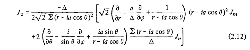

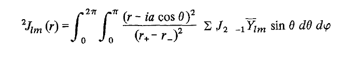

Calculate the source term ##^2J_{lm}## while knowing by integrating the known quantities.
$$ ^2J_{lm}(r) = \int_0^{2\pi} \int_0^\pi \frac{(r- i a \cos \theta)^2}{(r_+ - r_-)^2} \Sigma \ J_2 \;{}_{-1}\overline{Y}_{lm} \sin \theta d\theta d \phi$$
Hello, the Homework Statement is quite long, since it includes a lot of equations so I will rather post the as images as to prevent mistypes.
We need to find the integral
Double integral over theta from 0 to pi and phi from 0 to 2pi of (r - ia cos theta)^2 / (r+ - r-)^2 times the sum of J_2 and minus-one Y-bar lm times sin theta d theta d phi, defining 2J_lm(r).
where
with
J_m =(\sqrt{2}(r−ia\cos⁡θ))^{−1} i(r^2+a^2)\sin⁡(θ)j,
J_n = - \frac{a \Delta}{ 2 \Sigma} \sin(\theta )^2 j,
j = C \delta(r-r_0) \delta(\theta-\pi /2),
where δ is the dirac delta function and with
\Delta = r^2 - 2 M r + a^2
\Sigma = r^2 + a^2 \cos(\theta)^2
$$Finally ##(r_+,r_-,r_0,C,a,M)## are constant and ## {}_{-1}\overline{Y}_{l,m} = {}_{-1}\overline{Y}_{l,m}(\theta,\phi) ## are the Spin-Weighted Spherical harmonics.
We were also given the article Stationary electromagnetic fields around black holes. II. I understand that not everyone has access to it. But I've provided everything necessary here.

Anyway, I don't finish the calculation there because my integrated source term is at least cubic in the variable ##r## but the one in the article is only quadratic in ##r##.
To be more specific in the article they state that ##{}^2J_{lm} \propto \Delta##
Comments on how to improve this post are very much appreciated. Thank you.
For clarity I finished the calculation using rules for Spin-Weighted Spherical harmonics and corrected a typo. I've modified the notebook and the pdf. But the problem of course remains.
