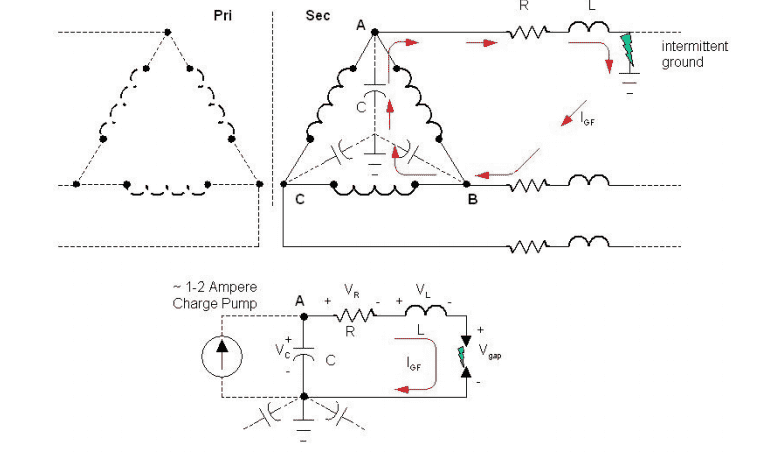

I found this picture on the web (see below), going back to my original image in post #1: Can we say that the currents with the fault will be the same as before, but phase A has the additional capacitative current?
And I assume this current is small, so small changes in line currents basically?

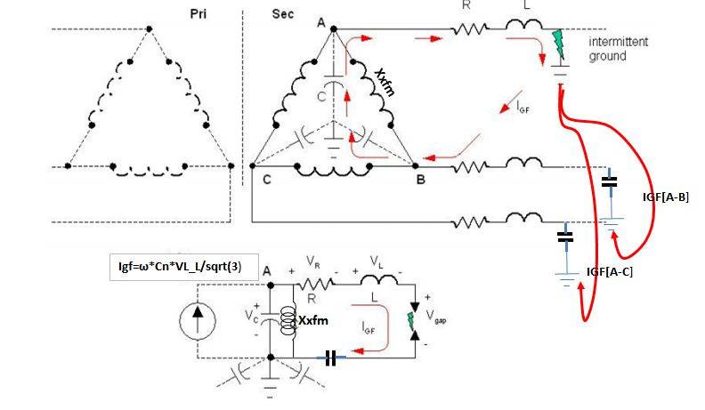

245329
In my opinion, generally speaking, this diagram is better.
245476
Usually, since Xxfr <<XC you may neglect the transformer impedance [also R and L of the line] and so the charge capacitive current will be:
Igf=ω*Cn*VL_L/sqrt(3) where:
ω=2.п.f=314.16 for 50 Hz
Cn=2*п*ε/ln(D/d) ε= 8.85E-12 F/m
D=conductor centerline-to-centerline distance
d=conductor diameter.
VL_L line rated voltage [phase-to-phase]
For a 2/0 AWG [10 mm diameter] 1 m distance overhead line 35 kV 30km Igf=2 A but for the same conductor three-core cable Igf=30 A.
For higher voltage the current rise proportionally [approx.]

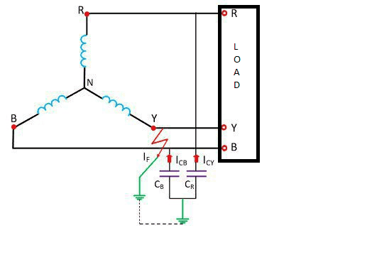

Fair enough, but consider the following schematic below.
If I measure voltages and currents at points located directly after the ground fault.
Now my phase to ground voltage measurement will read zero in phase Y.
How can I calculate the total power in an arbitrary phase now?
Sy = Uph*conj(Iph) will give me zero, because Uph is zero.
But I know the load will continue to work as normal, because its connected line to line and the system is "ungrounded", hence drawing power.

First, you can simplify your schematic by connecting the Gnd symbols with a wire; then eliminate the Gnd symbols. This is valid because all Gnd's by definition are the same point.
This will show that you have two capacitors in series between the "R" and "B" phases, essentially a capacitive voltage divider. The fact that they may be connected to the Earth is irrelevant, there is only one place for the current from either of them to go: the other capacitor.
Unless either Voltage or Capacitance are infinite, there is a finite, measurable, current flowing. The voltage at the junction of the capacitors (the point that used to be Gnd), measured to one of the phases, depends on the ratio of the capacitor values, and of course the phase voltages.
Also, the current available at the capacitor junction depends on the applied voltage, its frequency, and the capacitors values.

The simple answer to that question is "Yes" .
I really recommend you get a copy of "IEEE Green Book", standard 142.
Its early chapters explain clearly the basic principles on which the practice of grounding is built.
Familiarity with it makes a lot of the mysteries of the NEC disappear.
Once you train your brain to think of "ground" as just another wire that goes most everywhere these mysteries become almost intuitive.
Yes your load current is hopefully so large compared to your capacitive current that the system operates, to all outward appearance, normally .
So it's tempting to make industrial systems ungrounded to promote fault tolerance.
But you need detection of that first fault because should a second one come along on a different phase, now you have a dead short and two electrical explosions one at each fault.
IEEE Green Book's first few chapters explains all this, at length in plain language , then the authors go into extreme detail .
In the real world of industry we approximate an ungrounded system by grounding it through a considerable resistance - roughly equal to the capacitive reactance of the distributed system.
There's a clever reason for doing that, namely the phenomenon of "ferroresonance".
Should an inductance in the system, say a motor or transformer winding, happen to make a series resonant circuit with that distributed capacitance ,
well,
do you recall from your basic circuits course that the voltage gain of a series resonant circuit is its Q, which is its X/R? Ratio of energy stored to energy dissipated per cycle?( see wikipedia's entry for Q_factor )
That can really happen and the high voltages produced by resonance will pierce the insulation.
So we place some R across the XC to prevent a high Q resonant situation.
And we monitor for presence of an unwanted ground so we can dispatch maintenance people to find and fix it before a second one comes along and disables the system.

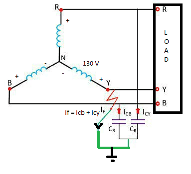

During a single line to ground fault, the voltage across the healthy phases increase to line to line voltage. I.e. the voltage triangle remains intact, but the neutral point is shifted.
I'm not able to fully understad why, or show with eq's that this is true (I have seen it in real life, so I know it's true, that helps but still..)How should I start setting up my equations, to prove that the neutral point now is not at the same potential as ground?
245702
My take at the problem without equations:
The voltage (130 V) across my Y phase coil, i.e. V_{y}, will be present even during a single line to ground fault.
But because the + side of my Y phase coil is now at ground potential, the potential of V_{n} with respect to ground now has to be +130, i.e. the polarity of my Y coil shifts?
Is this the correct way of thinking, or am I simplifying things here?I really appreciate your help.

Yes, knowledge is humbling isn't it ? Appreciation of the abysmal depth of our ignorance is the beginning of wisdom...Yes you are basically correct in your analysis But you flipped a sign.
That's why we must be rigorous in applying Mr Kirchoff's gifts to us, 'the basics' .
245732
It's important to remember that voltage is Potential Difference
Difference is a key concept - whenever you speak of voltage be sure to keep in mind between what two points.
It takes two points to define a voltage and that's why voltmeters always have two wires.
Develop that awareness early on and it'll prevent lots of confusion in your later studies.old jim
