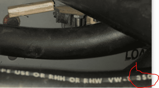

Those phone numbers arent to that company anymore and I could not find who took over this product online but good thought i might be abke to pursue this further. Also 350 mcm or kcmil sound right I originally thought 500 off the top of my head but that puc says 350 amd there's two per phase. We cannot change the design specs unfortunately and the gen neutral is ungrounded for its application so it must stay that way. I do find this style of ground fault current sensor ridiculous for this application and it will never even work as inteneded on a true ground fault because there will be no fault current returnining to the neutral. Even more sily is that if there was a second ground that caused a short circuit between phases it would trip the 1000 amp magnetic breaker but the ground fault current sensor would in theory not detect a “ground” because all the supply current was returned from the phase wires to the generator stator and it would not detect leakage back to the neutral
jim hardy said:
it sure looks like something that could've got knocked loose while manhandling those cables...

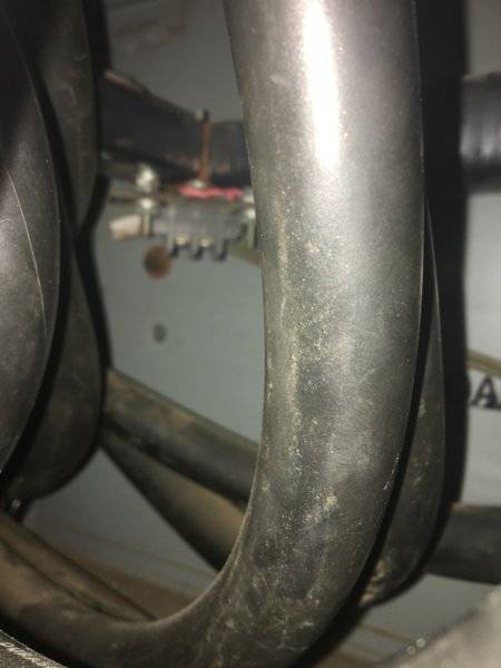

I am thinking it's likely either the burden resistor or a resistor they put there to protect the CT from somebody lifting a wire down at terminal 21 or 22 of the relay.
In either of those cases it ought to be connected.How big are those wires ? Do i see 350kcm ? Are there two per phase or just one ? If two, do all six go through the CT ?
grabbing at straws now

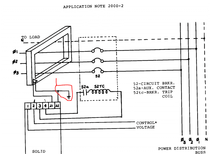

i don't know what is the purpose of this ground jumper
but some draftsman thought it important enough to put on the drawing. Good question for that 'gray haired engineer' ?

Also good observation on the bond to ground on the secondary CT wiring. I was not able to verify if that existed in the field but next opportunity I will have them look for that

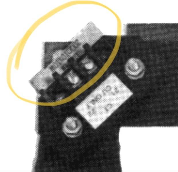

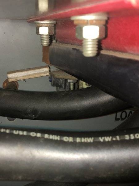

I have tried to read each post - but do not see if the Burden Resistor has been re-connected. Pretty sure the Relay is V sensing and the burden resistor is NECESSARY -and IMO the one shown is not mechanically sufficient for this critical item- note the Mech design of the one in Don's Post 24). With the burden resistor disconnected, the CT output is open circuit and sending HV spikes to the relay - the relay sense circuit is (likely) quite crude.
Also - large window CTs are not perfect, the location of the cables will cause an apparent imbalance, not enough to normally look like 200A worth!~ but with the burden resistor missing...
Also - as a test, use a clamp on CT and measure the current in the ground/ neutral connection ( this can be done without disconnecting it) - not 200A, I am quite sure.
Another test - with a current source, like a MCB test set, you can wrap a cable around 10 x and pump 20 A through it to get to 200 A... and do this test with and without the resistor connected. I'll bet it trips at about 20-30A effective ( 2-3 A x 10 turns) without the resistor and --- 200A with the resistor.
I zoomed in on the vendors manual image and the resistor i saw hanging is definitely the burden resistor designed for the sensor. 200 ohm 10 watts it looks like it says just like I saw. Unfortunately i won't be able to have the resistor hooked back up and run the test again until the load bank trailer is rescheduled but this is a huge clue.
well i think you're almost there...
with that resistor missing it'll be spectacularly oversensitive.
If you can hang a simple battery handheld 'scope across it it'd sure be interesting to see the waveform . 60 hz, 180 hz, or a mix ?

So we finally got the vendor back with the load bank. We reinstalled the burden resistor across the CT and viola we cranked the generator right up to 570 kW with no issues. Problem solved! Thanks everyone! Now what's going to eat away at me is the electrical theory aspect of why with no ground fault current and with the CT core both not a fully rectane and also installed correctly fully enclosed, how was a voltage being induced onto the secondary winding of the CT? I guess without the burden resistor the secondary circuit is an open circuit but how was anything at all being induced into secondary circuit to mess with the solid stare ground fault relay? And why was at always when we went over 350 kW, 400+ amps? It consistently tripped at the exact point. My mind would think that if the CT secondary open circuit is screwy it would just trip the unit as soon as a load is applied? Any electrical theory thoughts on why an open circuit CT gets an output at with no magnetic field from the load cables?
The short answer is - the world and the things we build are not perfect.. in that there are a few issues. As I mentioned these large window CTs are not very accurate, and the location of the cable in the rectangle (window) affects the magnetic linkage between magnetic field created by the current in each cable, and how much of this is established in the core of the CT. Example : Cable A : 99.5%, Cable B 99%, Cable C 98.5% = at some point in every cycle it can look to the CT as 1% current "missing" in the A+B+C = Ground Current equation.
Additionally there may - or probably is some Ground leakage, but how this would be load dependent? -- requires more input.
The CT is Current to Current device, or a current source... it will "push" current out to match the ratio ( probably 600:1, maybe 600:5A ) ... the relay is high impedance like > 10K ohms, this makes the system far more sensitive (> 50x ) to even the slightest output.
In reality - this system likely operated according to "theory" - it was just not configured properly. This is a human error, not an electrical system error. All of the system was static - not changing, the cable location, the CT Secondary Burden, etc... so the trip point was consistent.
